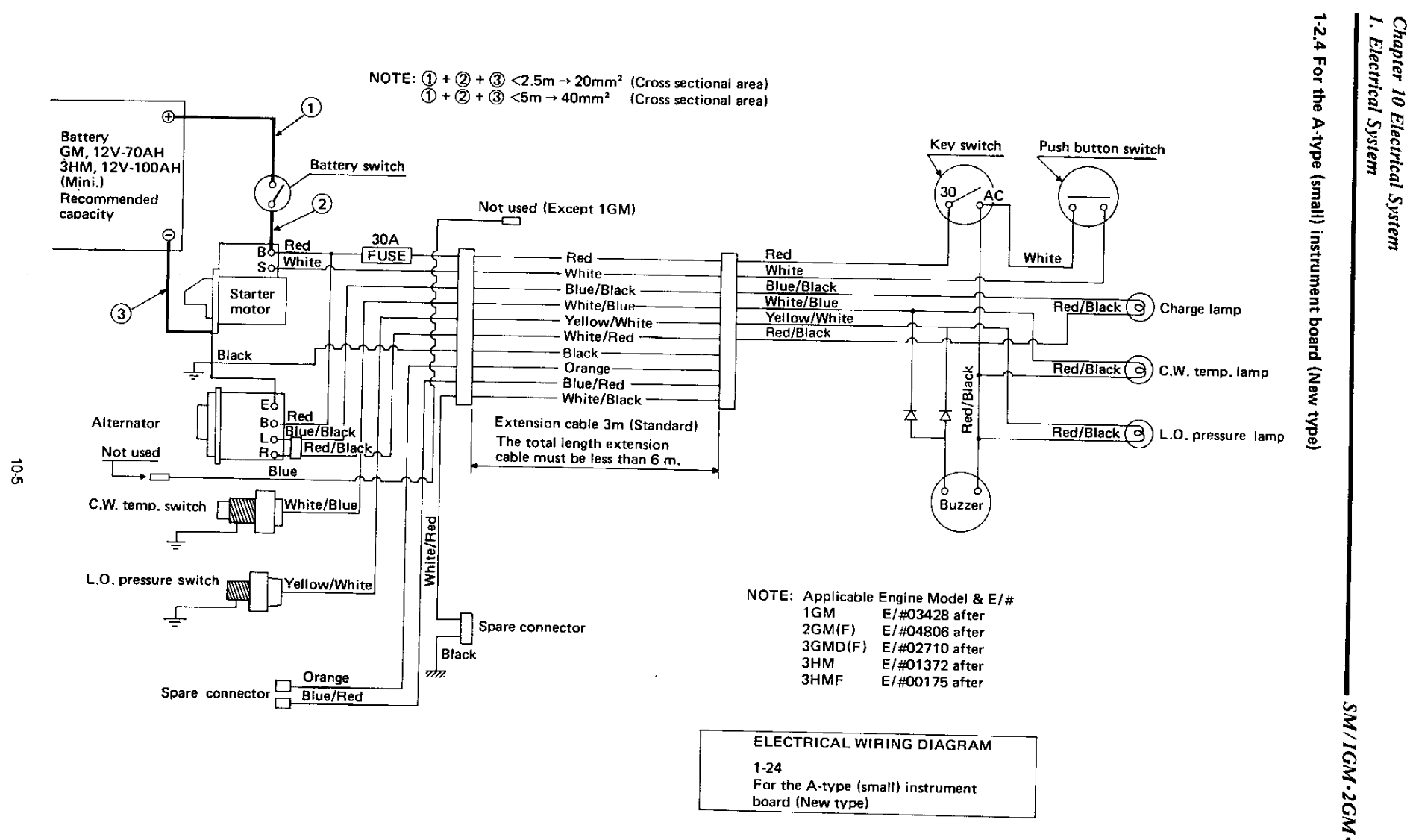

I am surprised that no one has mentioned the 30 amp fuse, just to the right of the starter in the schematic diagram posted by @jjgrizzard. This fuse is housed in an in-line, non-waterproof holder in the wiring harness, near the harness connector. Corrosion in the fuse holder will cause the intermittent engagement of the starter motor. Cleaning the contacts here (and the wiring harness connector while you're in there) will restore reliability. Nothing wrong with the Cole Hersey solenoid and new wiring either, just a lot more work.
