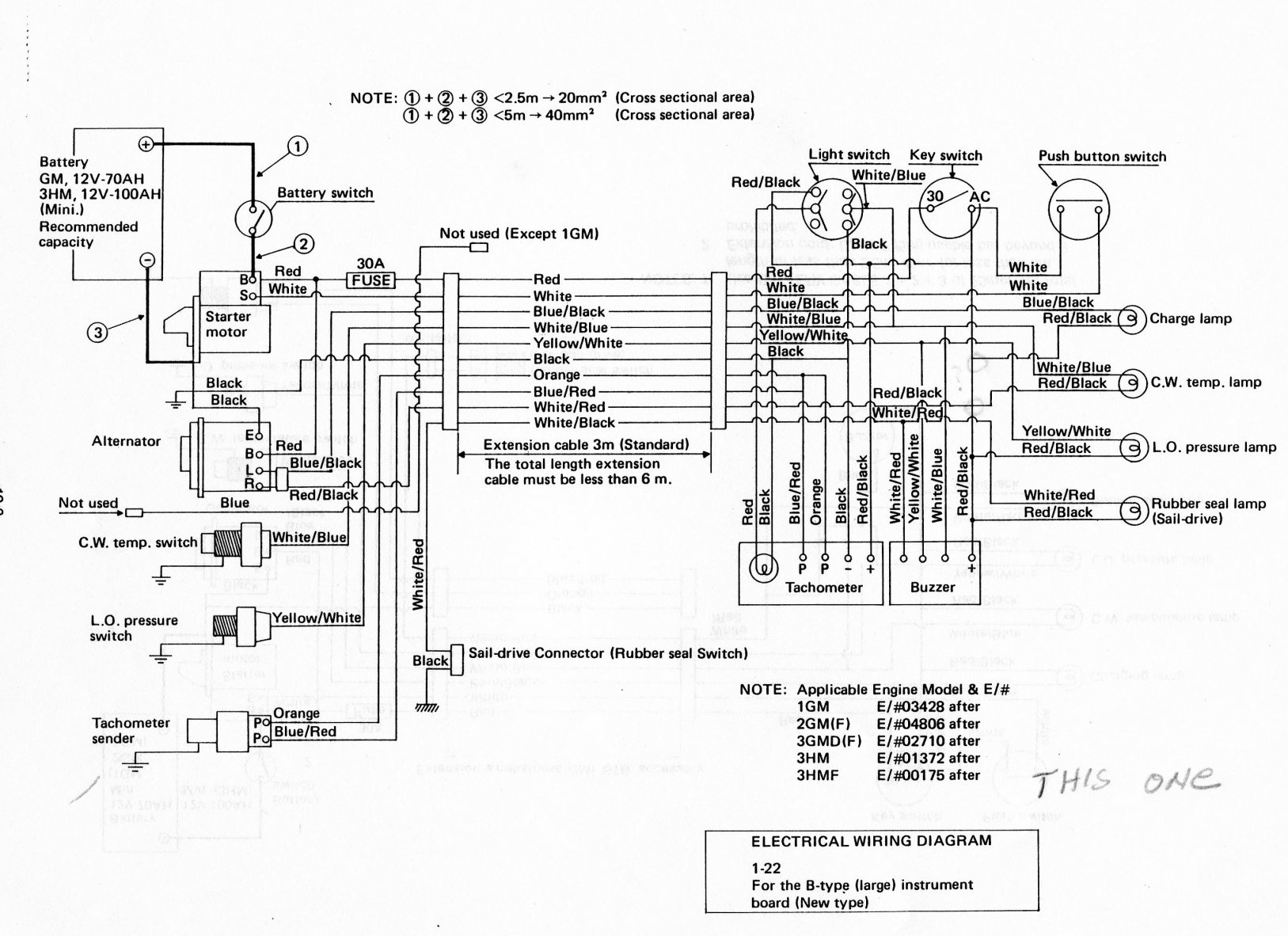

Pretty much the same here.. I used 10 ga wire from the starter "hot" terminal to bypass all of the sketchy multi-pronged connectors .. I had tried cleaning the connections and that would work for 6-8 months.. If you look at the wiring diagram, you can see that the original power to the panel and back to the solenoid has to get through 4 connections that used to be sometimes clean and waterproof..

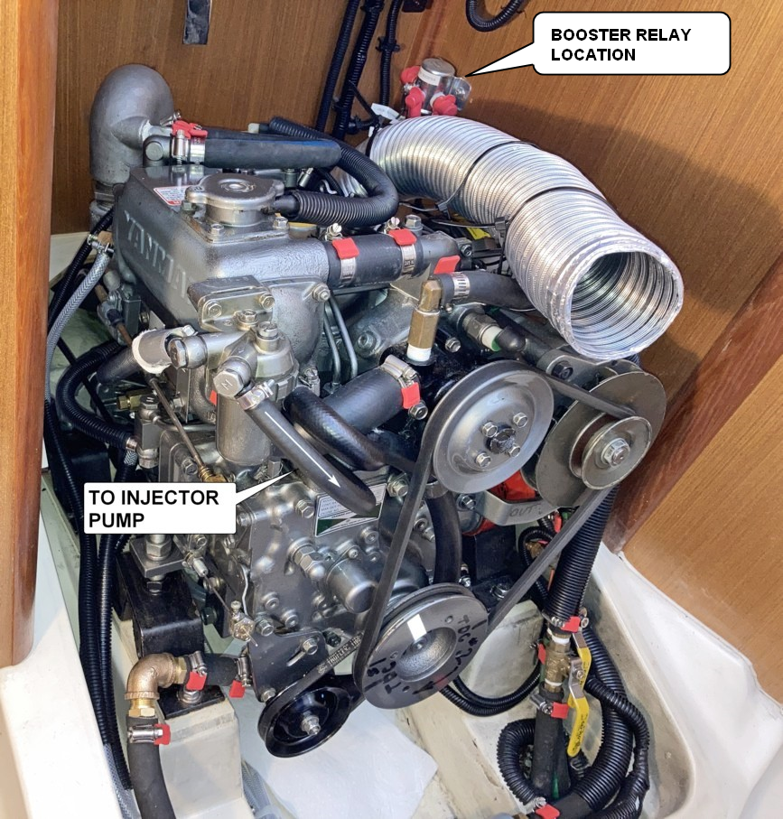

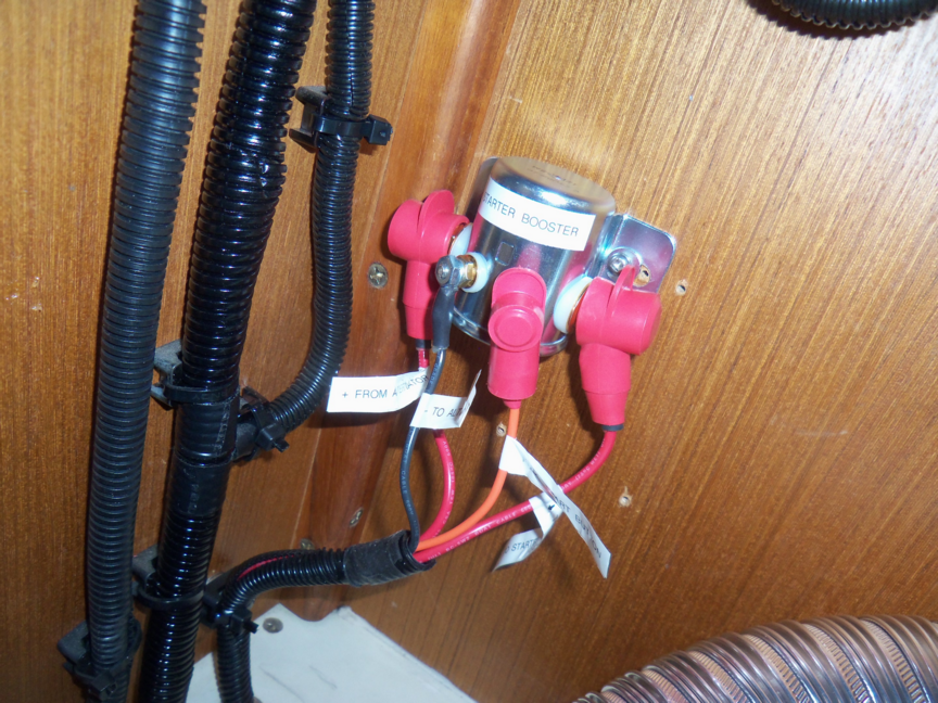

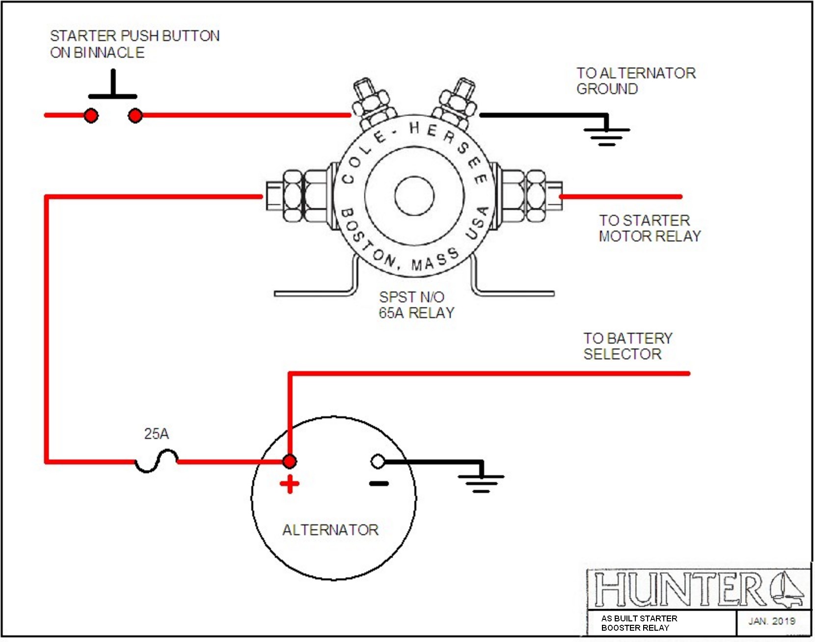

Solution attached :
The reason for installing a booster relay is to avoid the complication of running heavier wire from the starter button down to the engine starter solenoid. All wiring is localized at the engine and within 2 ft. This relay is mounted on the bulkhead beside the engine.
The alternator has no significance other than having large convenient (+) and (-) posts as a power source in the "as built" drawing.

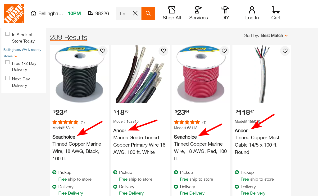

@DStegs49 , I sure wish this was available in Canadian Home Depots. These are top of the line brands of marine wire and I'll bet the prices beat the can off your neighbourhood chandelry for the same brand wire..
This is definitely where you want to shop for marine wire.

Solution attached :
Hey Ralph, where does that red wire on the left of the pushbutton go?
