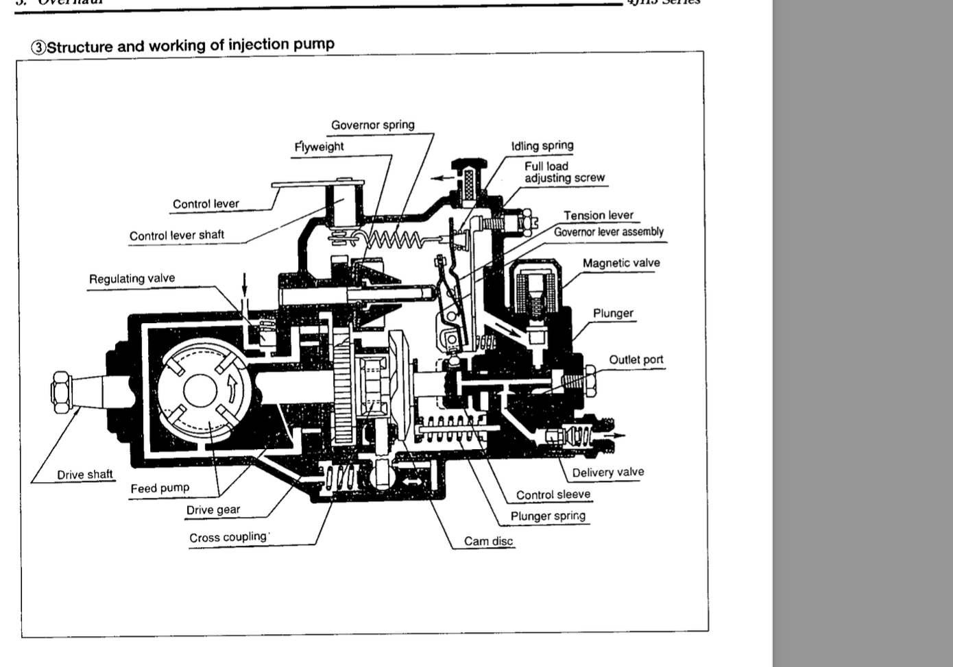

Is solenoid a rod that push the bar for the kill and not a a valve on the fuel line?
Yes. It moves the fuel rack to a no pump condition. You do not want a valve which just closes off the fuel.

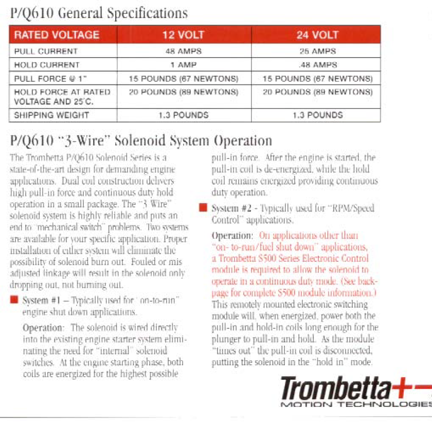

Two years ago I was going to install a Trombetta P/Q610 Series solenoid but decided it wasn't worth the cost for just an extra toy. If all engine shut down solenoids work the same, the solenoid requires a large pull in current of 48A and then immediately goes to a holding current of 1A as shown in the manual :
The solenoid requires power to allow the fuel rack to open.
If the solenoid had stayed in the "pull current" position they would have burned out but they always require power for the engine to run. When you punch the STOP button, power is disconnected from the solenoid and the fuel rack returns to the no fuel position. Engine stops.
In this case, the engine would never start. This is starting to lean towards the OP's problem but his engine does eventually start after a long cranking session and then goes at any and all speeds. I don't think this applies to the OP's question.

Interesting device.
Notice it has a 3 wire connection, which implies some “smarts” which take the solenoid to a low power mode once extended. Not sure, but I’ll assume they have a second coil in the housing.
This wouldn’t be inexpensive, bad not standard for an oem boat builder.
I personally know both boats that had engine fires owing to stuck solenoids, So, this company clearly knows the issue

Interesting device.
