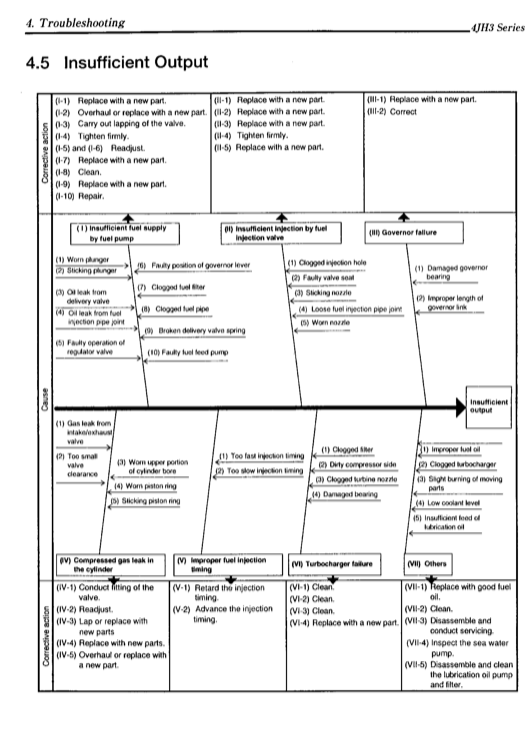

smokey 73, my comment about a "bypass valve" comes from looking at a description and parts list from the manual showing a diagram of the actual turbo. The engine in my Hunter 50 is turbocharged and I did not remember seeing any plumbing that wold indicate a "bypass valve or wastegate".
My attachment was just about possible causes of the lag in power output from the Yanmar manual.
Sorry @SEMPERAVANTI41 - I interpreted your reference to the table you posted as the source that there was no bypass valve rather than a parts list or diagram. I'm surprised there is no wastegate but then again anything is possible. Hope you get it sorted. Still sounds like turbo lag but I don't know why it would be only when hot unless something happens in the turbo when it gets hot?

Sounds alot like "turbo lag" to me. Does your turbo have a bypass relief that may be sticking open when its hot?
As stated above, I don't see a waste gate or bypass relief valve, neither on the engine or in the parts manual.
