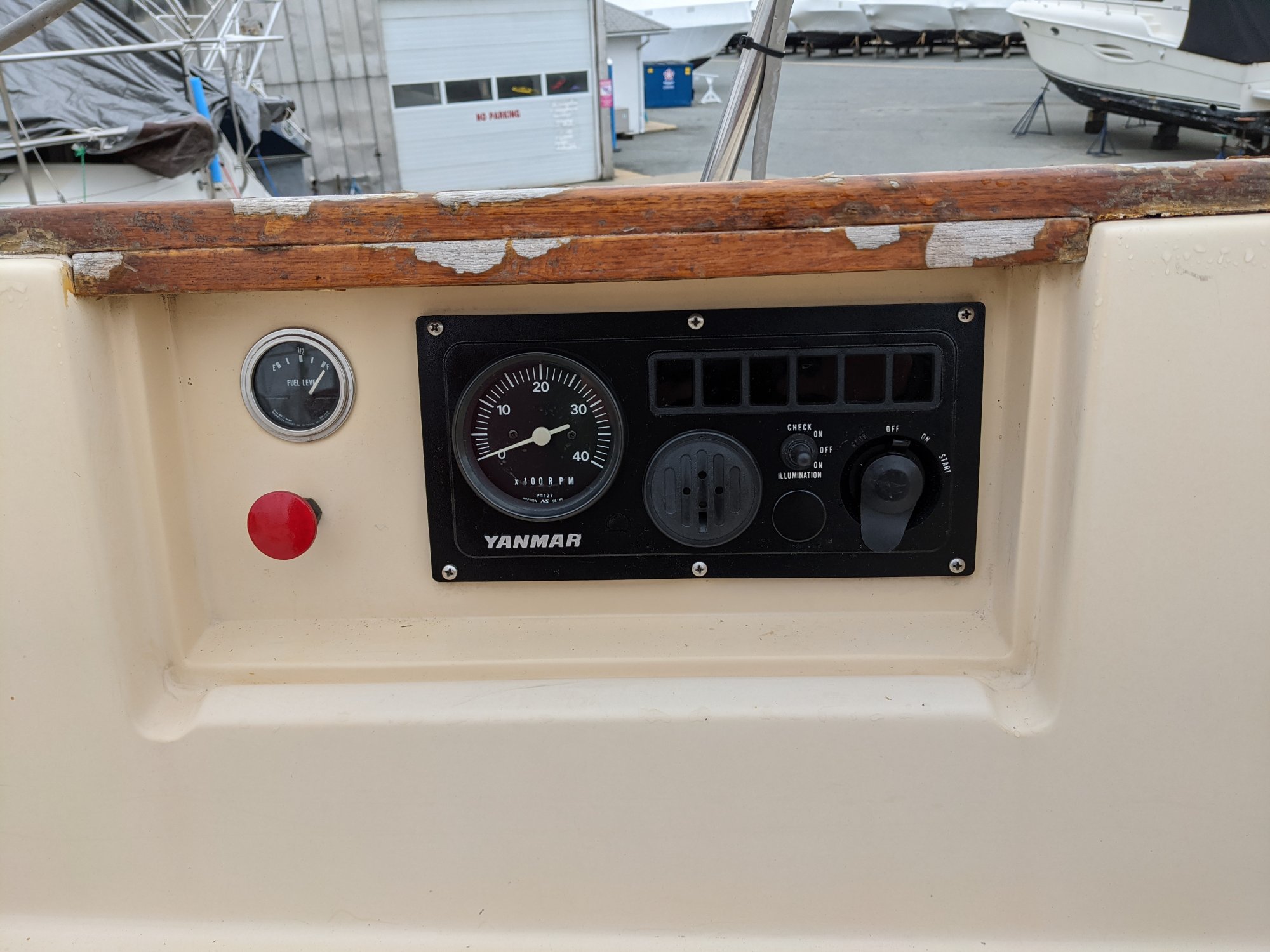

Look like this one? The toggle switch is for panel illumination and panel lamp check. The red knob to the left is is the engine stop, by pulling it out. Yanmar 4JH’s do not have glow plugs.

It looks like the key is marked:
Stop (not very legible).
Off
Run
Start
So, I would turn key to Start to fire it up, once running, let go of the key and it rests at the Run position.
I assume to stop the engine, turn the key to STOP. Once engine dies, turn key to Off and remove it.
BUT…I have no idea what the big red ejection seat button does…maybe the STOP setting on the ignition switch was erased intentionally because it doesn’t work (a solenoid I think) and they replaced it with a manual engine kill cable like my 2GM20 has….if so, pull the red thing to kill the engine.
The toggle switch is for the panel illumination. I assume the TEST setting turns on the idiot lights to make sure the bulbs work.

Yes that is it but no big red button do i turn the key to the left to ( glow for 15 seconds then turn to far right to start an leave it back to mid right for run ??? ( then turn to off an pull the fuel shut off just in side the companion way by the top step till it come to a complete stop ????
Sorry, I thought that was your photo Rick.
As someone else said, I don’t think that Yanmars have glow plugs. And if you ignition is as I stated above, there is no glow plug setting.
Set your throttle maybe 50%, turn key to START, engine turns over and starts. Release key to RUN.
Turn key to STOP (you might have to hold it a few seconds until engine dies). Return key to OFF and remove key.
Try that and see.
