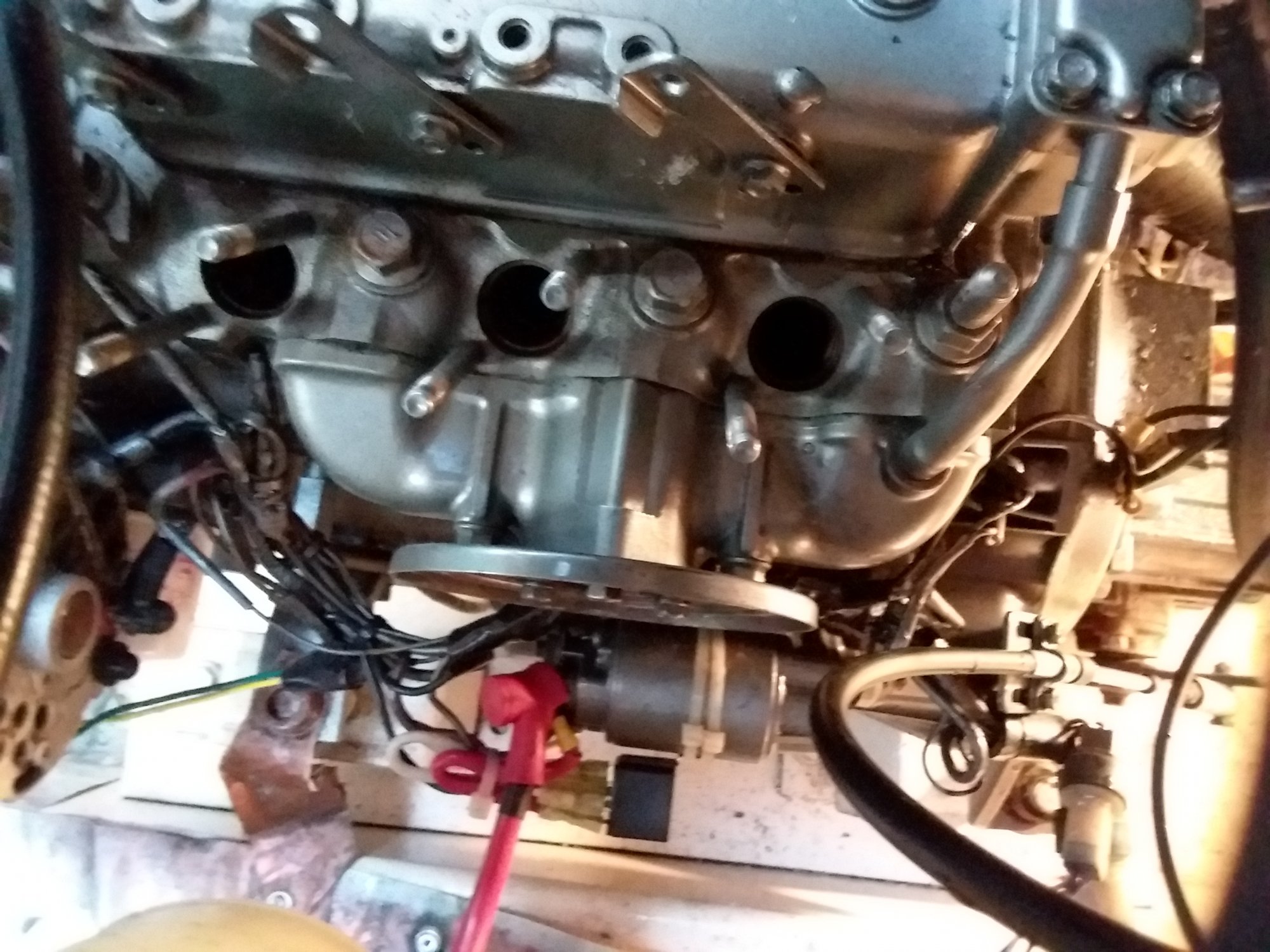

On the Yanmar 2QM15 there is a removable plug that is covers a port made for the Thermostart. It is just behind the intake air filter.
As per the attached picture made when I removed the injectors, the 3GM30F doesn't seem to have that removable plug. Do others 3GM30F owners confirm ? Incidentally, late in the Fall with colder temps and no glow-plug, in the weeks before haul-out my engine also takes a little longer to start. I crank up the fuel lever and after a few seconds it'll start and run rough spewing out black smoke for the first 5 or 6 seconds then clear up and run fine. I'm not worried about the black smoke as it is only momentarily and probably caused by the extra fuel. I have not had to blow hot air in the air intake.

Could it go here?
No. That looks like a head bolt. The port on the 2QM15 is there for the specific purpose of a Thermostart, as far as I know. Looking at your 3GM30F there is no such port. Does your engine have glow plugs? From what I have discovered, diesel engines with "pre-combustion chambers" should have glow plugs to aid in starting. I do not know about your engine but the 2QM15 has pre-combustion chambers but no glow plugs. I suspect the Thermostart was applied instead. Before I found the Thermostart I had rebuilt the engine including rings, replaced the injectors, upgraded the starting motor circuit, and re-plumbed the injector return line to the fuel tank instead of the secondary filter. Nothing helped with the cold start until I found the Thermostart in a tractor supply company.

After looking at the service manual, these are indeed the head bolts. And the manual doesn't show that port for the Thermostart like the 2QM15 has. And the 3GM30F does not have glow plugs !
