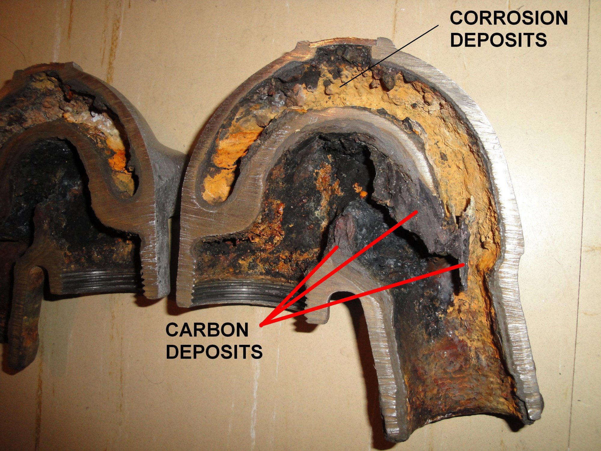

First and most important, I’m not a diesel mechanic or offering anything more than my limited experience with similar issues over the years. While I understand completely tearing into the elbow isn’t a quick job and shouldn’t be necessary on a 6 year old engine, the description is a classic example of a restricted exhaust.
The first sign of an elbow problem manifests itself when starting rather than running. Diesels need to ‘breathe’ more when starting when the exhaust back pressure is more critical compared with a running engine which is generating more positive exhaust pressure.

If the engine is 30 Y.O. and you don't know for a fact when it was last checked, it needs to be checked TOMORROW. Can't say that would be my first choice for starting problems (although it's still up there).
This is what you might expect to find:
It's what I found in mine.

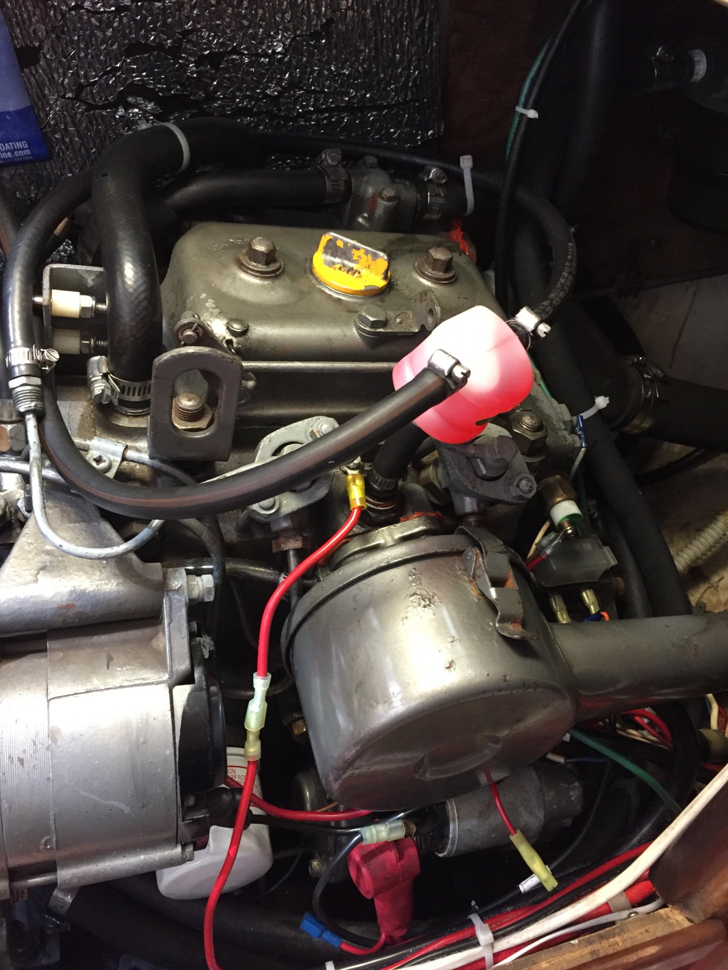

Yanmar tractors often use a Thermostart (not thermostat!) device for cold starts. This acts like glow plugs for engines not equipped with glow plugs. It heats the air in the intake manifold with a diesel oil drip flame. Each start uses about two drops of fuel. I have it on my 2QM15 and it works perfectly. Just apply power to it for 20 seconds before a cold start and you will start almost instantly. The device is inexpensive and readilly available. It screws into an existing port (on my 2QM15). Fuel is maintained in the small reservoir over the device by the injector return line. I have used this for years without it requiring any service. You must wire in a button to operate the Thermostart. I used a separate Yanmar start button I installed next to the engine start button and it is powered by the same circuit. photo attached.
