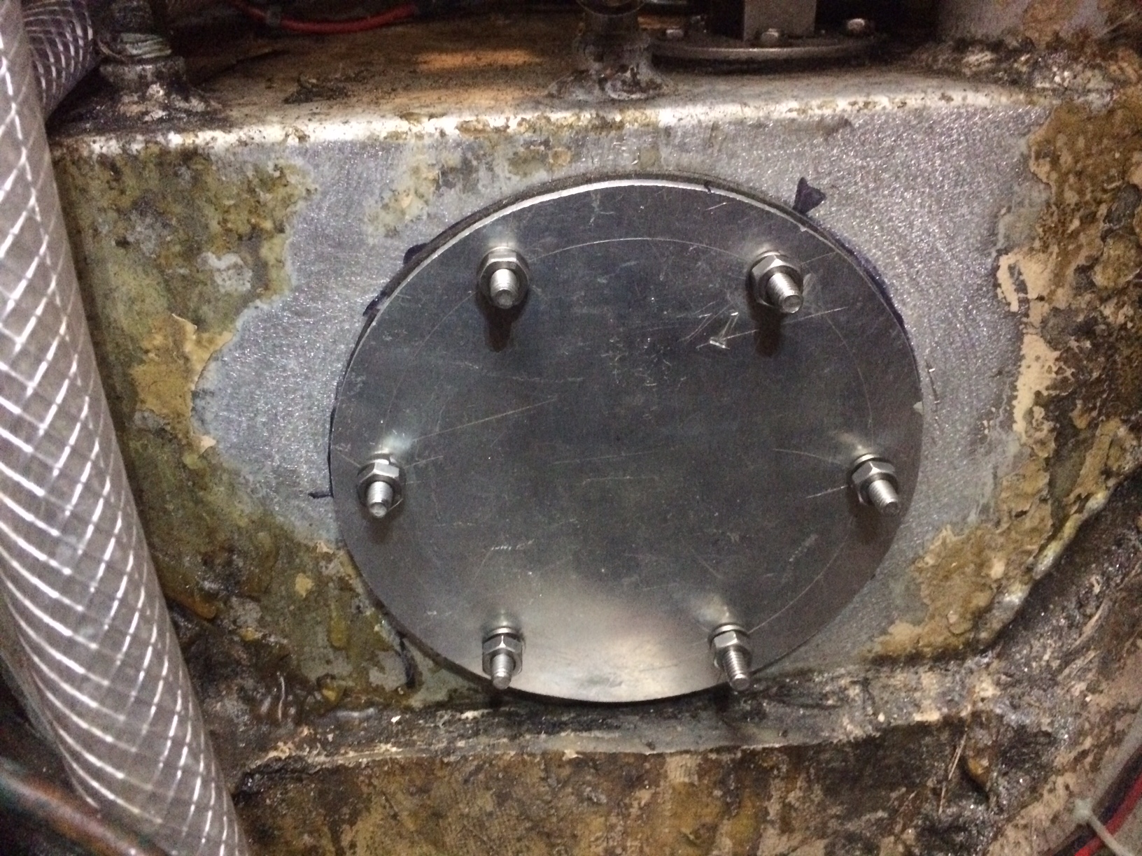

Here is a possible solution. In this case the tank was about 60" long and located immediately beneath the motor. I made up two plates/gaskets and installed one in each end of the tank. This tank was built in 1977 and had never been cleaned. Similar plates can be purchased from Seabuilt.
The only way you get rid of this problem is to physically clean the tank surfaces. Meanwhile store your tank empty if it sits for a long winter and use a biocide.
