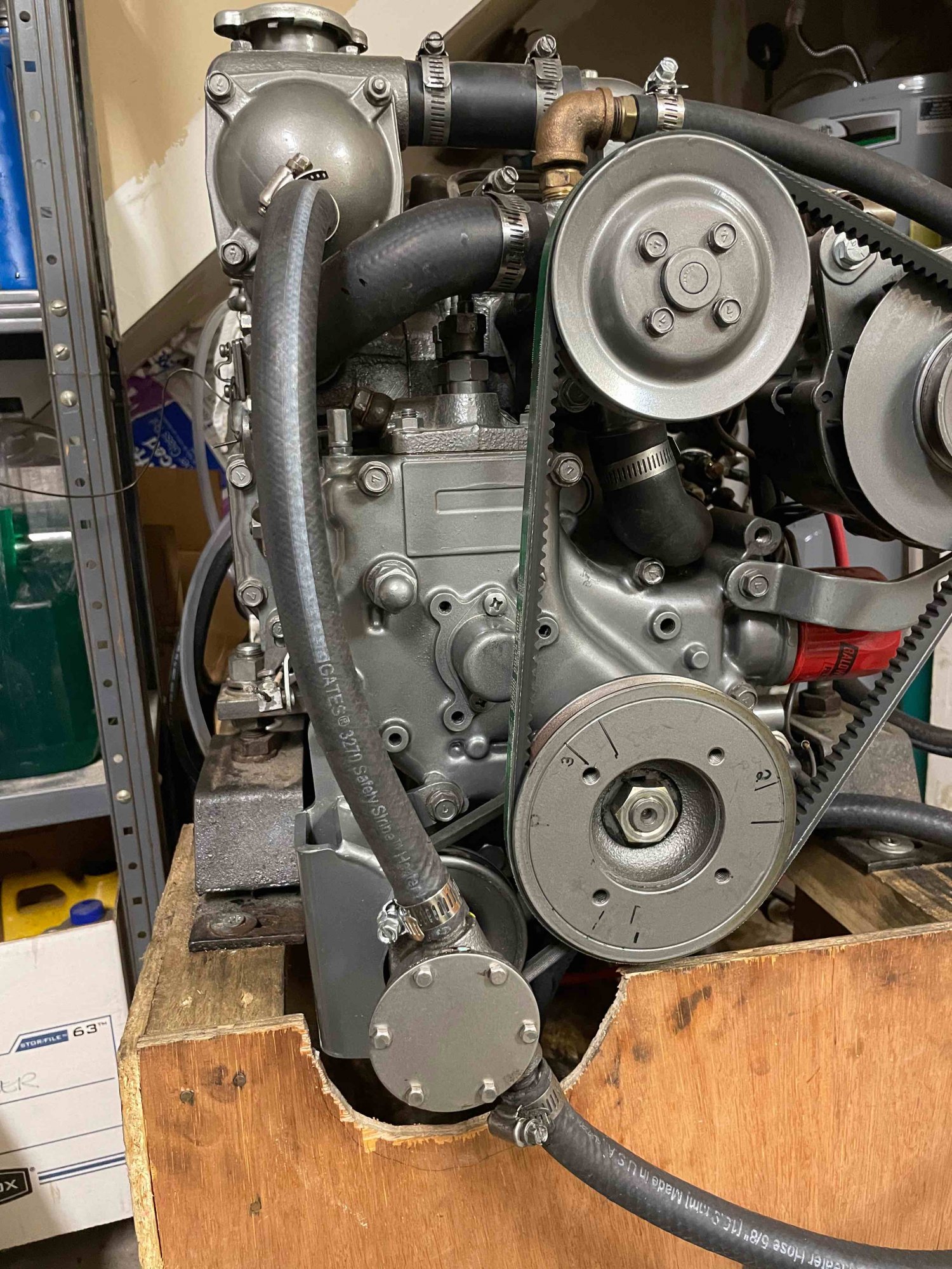

Yanmar 3GM raw water pump upgrade

Nice mod, I might consider this. Completely off topic, but is that motor in your basement?

Yes, I picked it up a couple years back and rebuilt at my leisure. It gets installed this week.

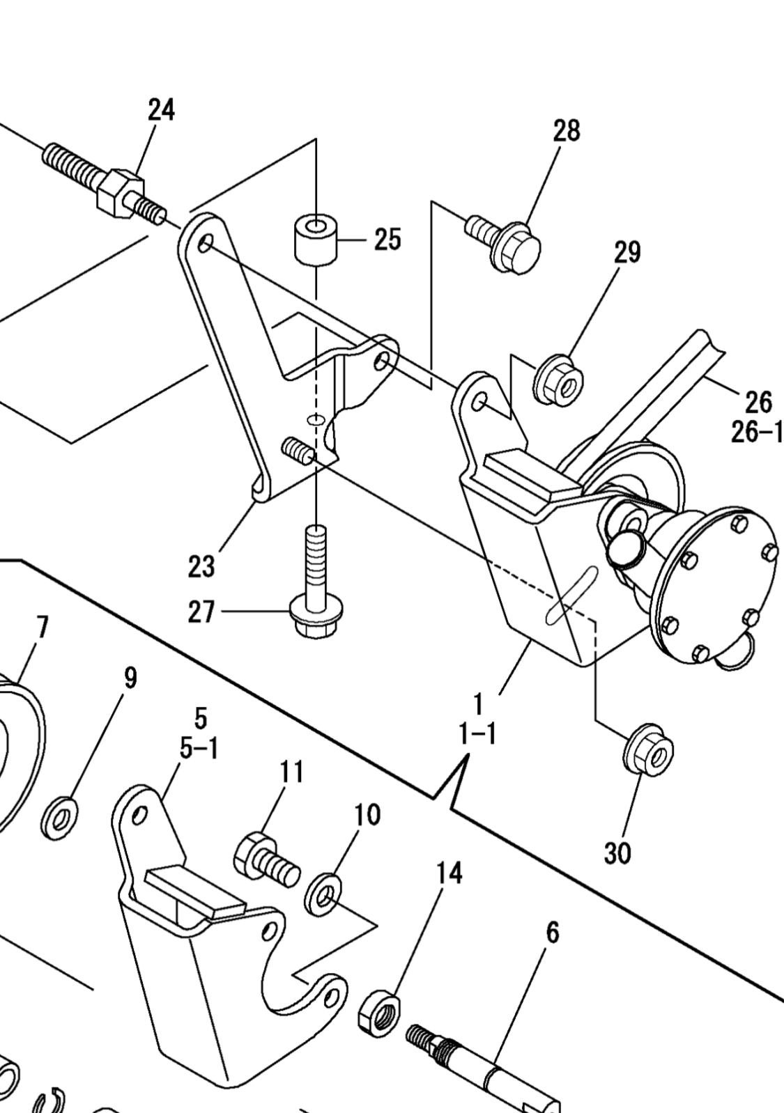

The only other comment I would add is that my solution to modify the original bracket into a back bracket is a bit clunky. A cleaner and stronger attachment might be made using the YM back bracket (#23 in manual, PN 128990-42160) or fabricating something similar.

Yes, Joker's thread was the guide I followed. However he mounted the new bracket on top of the old and I could not however get the alignment to work following his example, perhaps he had the other pump that came with some engines. This is why I modified the old bracket to incorporate an offset and allow the YM bracket to mount directly to the timing cover case.

P/N 128990-42160 is $189.74 plus shipping from Toad Marine. Yikes.
Yikes indeed. Funny it looks simple compared to the pump bracket with a welded gusset plate which is only $62 from my local Yanmar dealer. Perhaps my hack of the old bracket isn't so bad after all.
