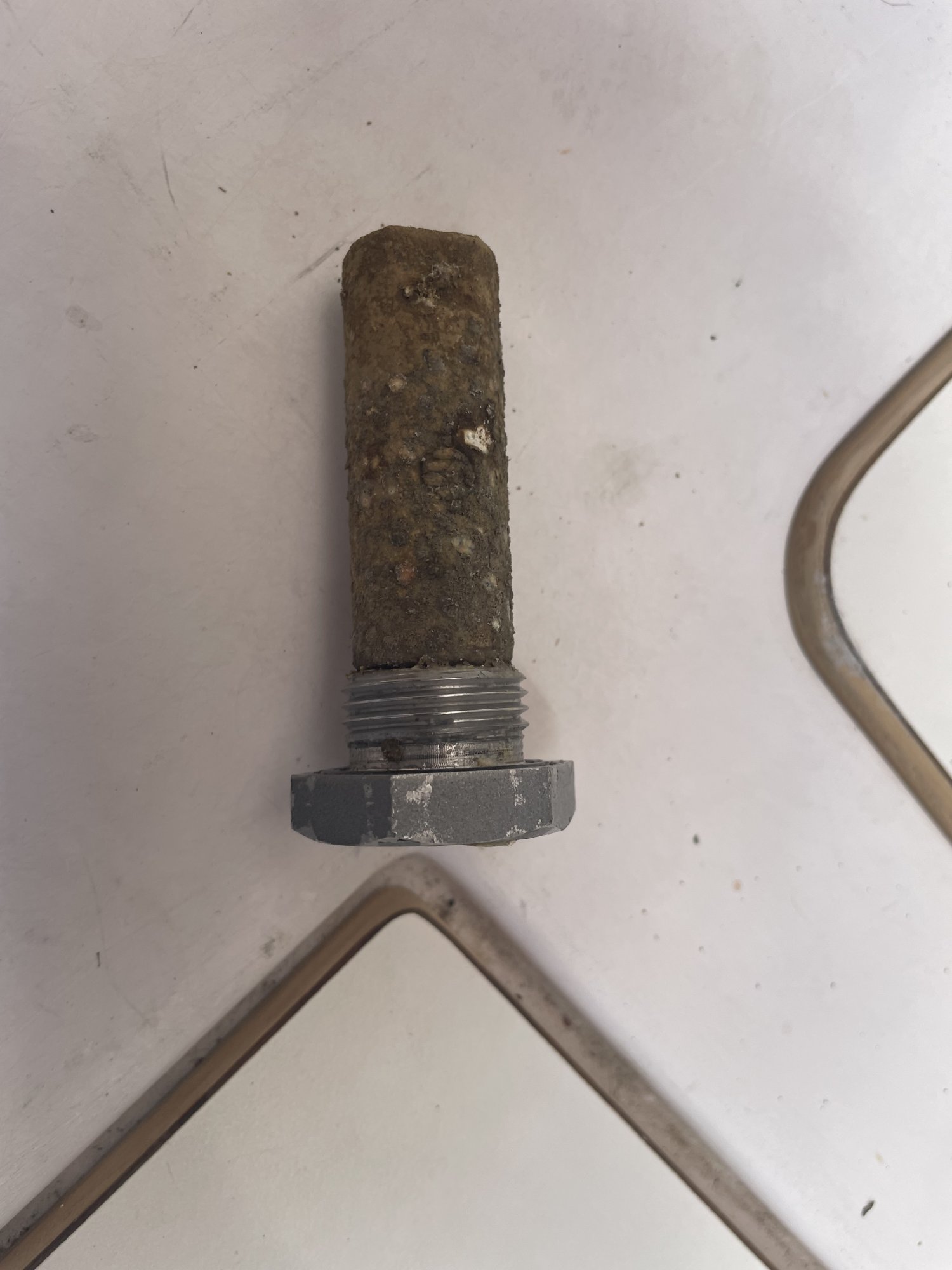

I was able to loosen the nut and replace it easily with an 18" breaker bar. Here's the old anode, which I'm guessing is original with the boat (2016). There's obvious discoloration but not much loss of mass - not sure if it needed replacement but I did anyway.
