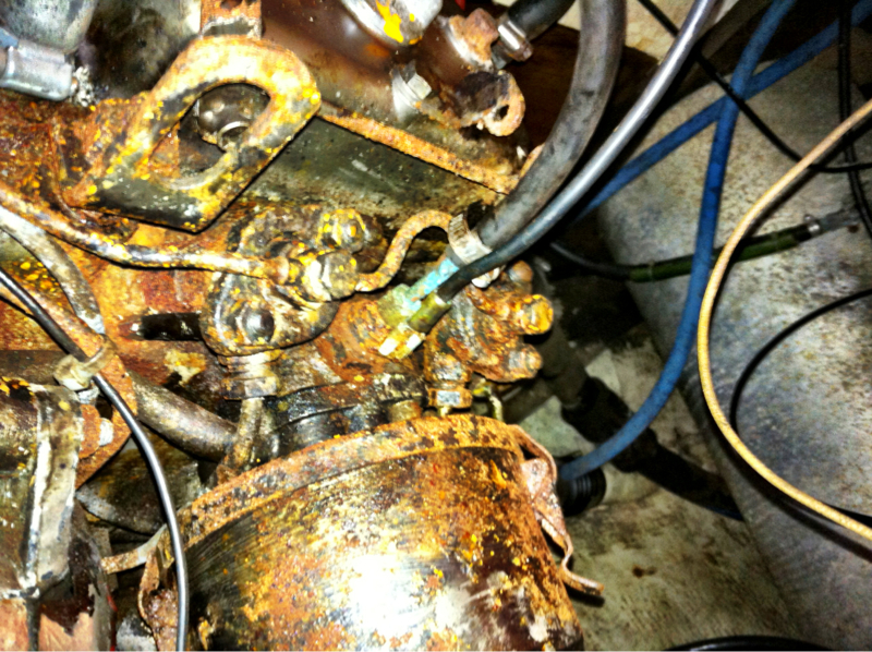

Hi Mike, as promised is a picture of my glow plug setup. From the colour of the picture it looks like it just hauled the engine up from the drink but it looks totally different in person.
All of this discussion about 1/3 throttle, 80% throttle, no throttle got me thinking; what does the manual say? My original manual says to crank with throttle wide open.
So today, I tried this. No glow plug. Air temp about 20deg C.
Turned the key, pressed the button and by my watch she started in about 8 - 10 seconds. Yes there was a bit of black smoke right after she fired but it cleared almost immediately. I've had the boat for eight years, never serviced the injectors.
So, to Stu's excellent point: it's a diesel (and an old one to boot!) it puts out a bit of dirty exhaust. It's probably just fine.
My two cents worth.
My two cents worth.
David and Stu, i appreciate your comments as well as all the others who have taken time to comment. It seems WOT start may be the way to go. I don't have an original manual. The picture of he glow plug may be helpful.
I will post again after going to th boat this weekend,
Glow plug, not a spark plug.

David, that is the Thermostart cold starter, like the one I posted from Hoyle Tractors.. Not a conventional glow plug since it also has a fuel connection to richen the mixture a bit ..
Thanks for the info. And for the Hoyle tractor link. I have been looking for the land equivalent of a 2qm15 so as to have an additional parts and info source.
Unfortunately, they were unable to tell me if there was a land version. I'm of the mind there has to have be one as it would not be profitable to make a specialized engine for marine only. Beta engines are Kubota for example.
