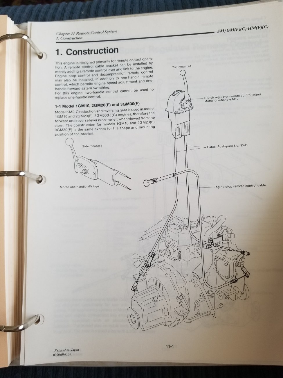

Thanks for the responses. I haven't opened the pedestal yet to see if the shifter can be reversed there, or if a bracket will have to be fabricated. Reading through the Yanmar Operation Manual that can with the boat, it says it came with a one-lever control and a two-level control will not work with a 2GM20F. See attached photo.

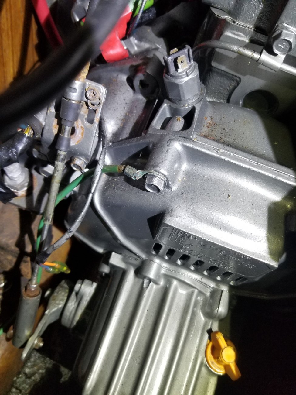

Here is a pic of the shift bracket on mine that results in things being reversed. I have seen pics with a bracket mounted at the lever on the transmission where someone fabricated another piece to attach to it so the cable would come from behind.

The painted bracket looks like it is a Yanmar part, while the unpainted is the modification. Am I correct, or are they both fabricated?

We have 2 lever controls on our boat, which had Yanmar 1GM. When we acquired our boat, the shift lever appeared to function normally, with forward pointing forward. I came to find out when I had the tranny re-built that the shift bracket on the bell housing was actually installed upside down, with that shift bracket pointing down. I believe it was the original part, and it was able to be installed upside down. So the cable actually was installed backwards, causing the shift bracket to function the opposite way than would be expected. I was told that there was something about the room in the Edson pedestal that made it impossible (or very difficult) to attach the cable in the pedestal to the shift lever correctly, and the solution was simply to reverse the orientation of the shift bracket on the bell housing and install the cable backwards. By putting the shift bracket upside down on the bell housing, the whole operation was set right.
It doesn't seem to make sense, but when I saw how the shift bracket functioned on the bell housing, I could see how the intended solution actually worked!
However, when I got my re-built tranny, with the shift bracket installed correctly, as shown in the installation manual, the cable was still backward in the pedestal. I had to get used to pulling back for forward and pushing the lever forward for reverse. I was told that they couldn't change the cable in the pedestal. Oh well, I just got used to it.

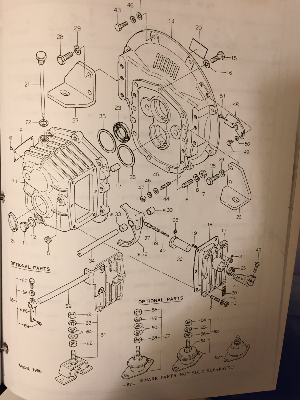

Some Yanmar engines have an adaptor part available to reverse the cable operation. It is in the parts manual as an option. It looks like a shaft that sticks out from the back of the transmission and has a bracket to hold the shifter cable.

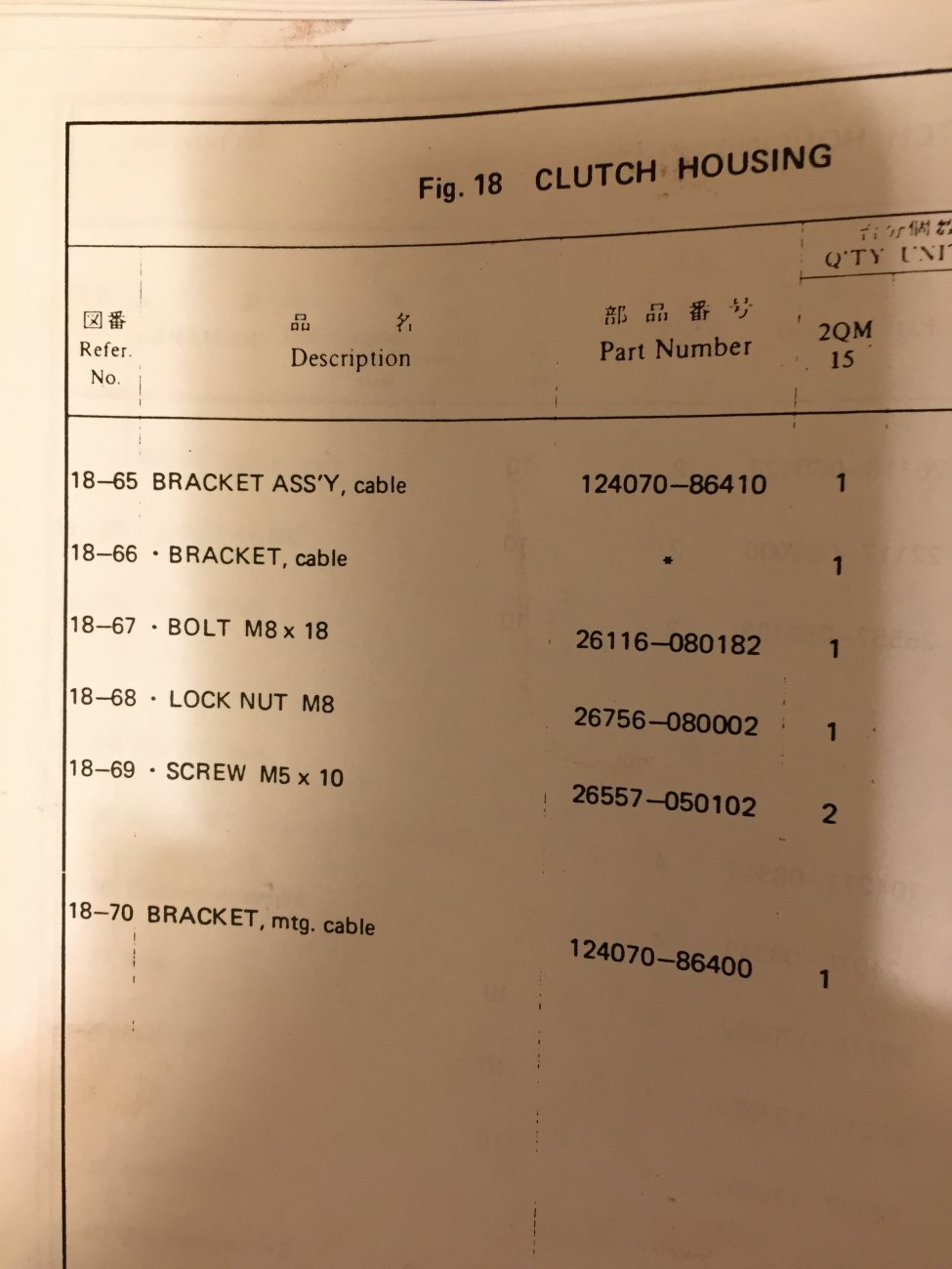

I think the bracket that attaches to the shifter so the cable comes from the rear is what I will need. Do you happen to have a part number? I can't find a parts catalog with it listed.

RKirk, My Yanmar is a 1979 2QM15 and the Parts Manual has the transmission bracket as an option. Attached here are photos that hopefully show the part numbers that you need.IMG_1136.JPGIMG_1137.JPGIMG_1139.JPG

Just an update on my problem of the shift lever on my Pearson 303. Thanks to the post mentioning the Yanmar transmission bracket that would result in the cable coming from the rear of the transmission to fix the problem, I purchased the part for $30 in Annapolis. Thought about trying to install it myself, but I couldn't quite reach through the access panel far enough to fo the job. Took it to Maryland Marina Monday for their certified Yanmar techs to do the job. They had a mechanic thin enough to actually crawl through the access panel and sit in the engine compartment to do the work. Took 7.5 hours to complete the job while the temperature was in the mid to upper 90s. It will be nice to finally have the shifter working as intended. Thanks for all the replies and helpful suggestions. Happy sailing.
