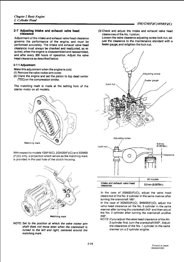

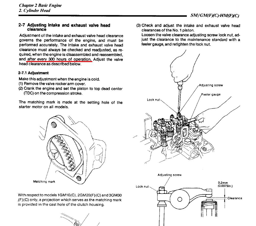

Owners Manuel requires adjusting valve lash every 100 hr. Because there are no hydraulic lifters solid pushrods require maintained clearance.

Adjusting the valves is easy especially if you can get good access to top engine. There's. you tube videos on it and lots info on line

When you peek through the hole in the back on the clutch cover and locate the timing mark, use a magic marker on the crank shaft pulley to make a reference mark. Then when you rotate to the next cylinder position make another mark. It makes locating the top dead centers easier the next time. I think I got that idea from Ralph. It was a picture he posted.
If the rockers (both exhaust and intake) for the appropriate cylinder are still tight you have to rotate the engine one more revolution to get that piston to top dead center. Then proceed with the adjustment.
I used a 1-1/16" socket on a breaker bar to rotate the engine. I can't remember if once the valve cover is off if that releases the compression. Maybe. It makes it easier to turn.
