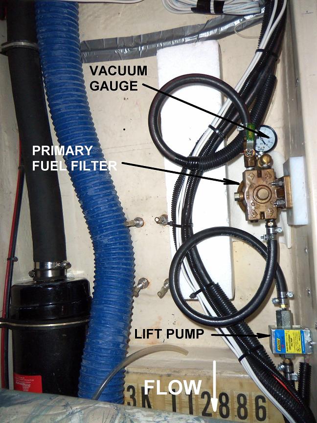

I eventually replaced my engine lift pump with an electric lift pump placed back in an open and convenient location. Just seemed to be chasing banjo fitting copper crush gaskets every few years. The very first fuel leak I discovered had soaked the rear starboard motor mount and that's where the battle began.
If you're looking for pump parts, you'll have to find a Yanmar dealer in your own area. Can you spell M O N O P O L Y ? ? ?
And yes, the pumps are not repairable. Another reason for looking at an electric lift pump and cleaning up the whole mess.

That was it exactly. Used a piece of 3/16" plate cut to the shape of the old lift pump base and used a pump base gasket to seal the old hole.
Here is the new setup back in an area which is wide open for maintenance .................
Now to deal with the leaking copper crush washers on the secondary pump :banghead:.

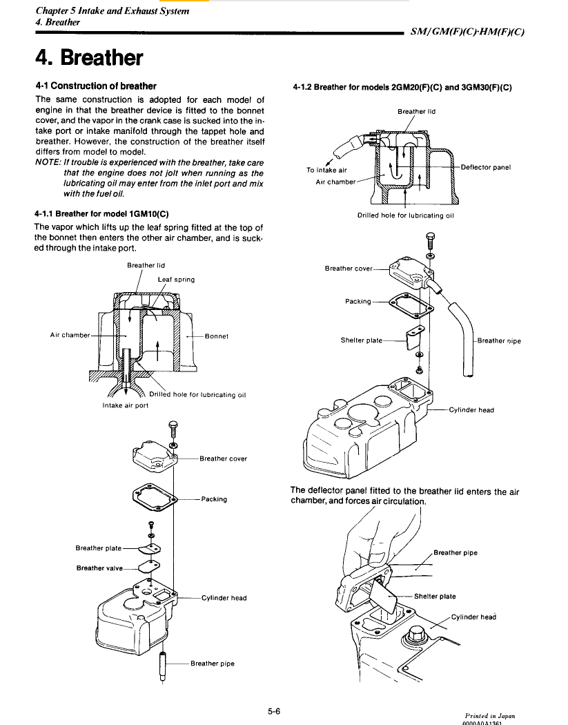

OUCH. Don't meant to piss on your corn flakes this early in the morning but it sounds like you "may" have excessive crankcase pressure to push oil out and around the dipstick seal.
I would suggest checking the breather and its tubing to make sure it has a clear path back to the combustion air inlet.
