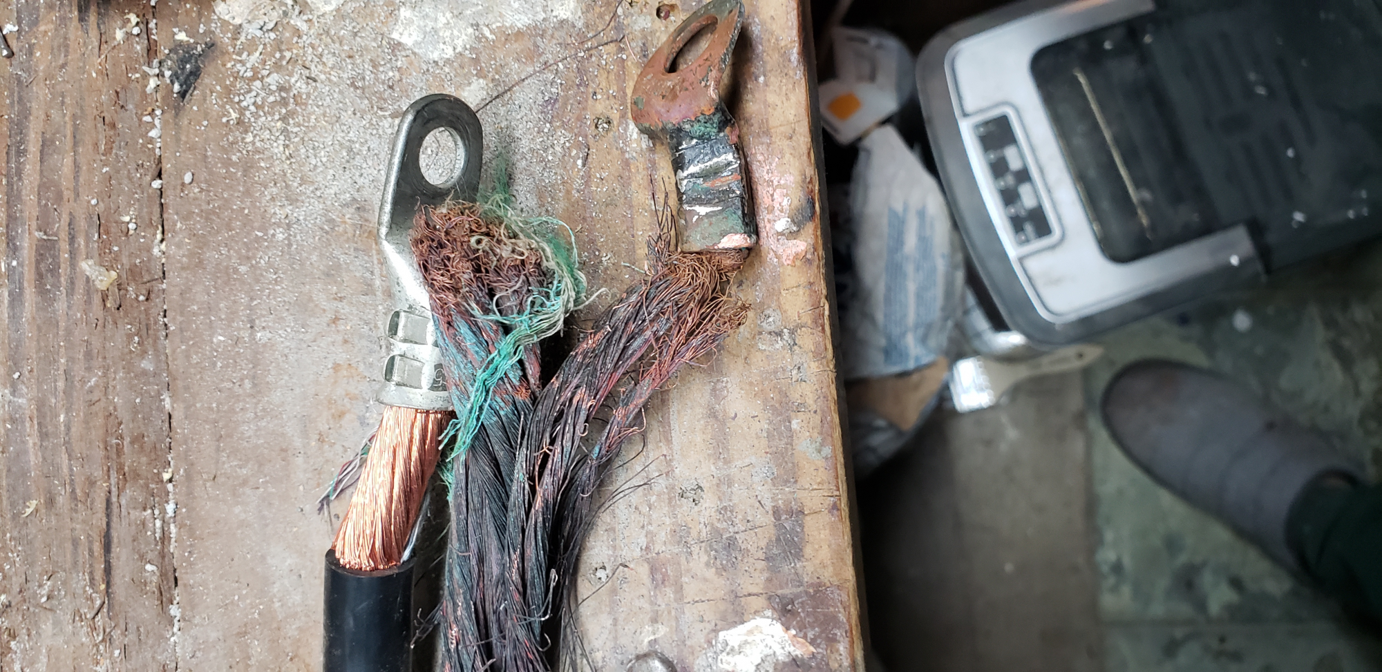

This suggests it is a battery problem. Could be poor connections or could be the battery. Check and clean all the connections, including the mounting bolts. The starter is probably case grounded, thus the bolts are part of the circuit. Pay particular attention to the DC- cable from the engine to the DC- bus or battery. Poor connections or corroded wire will cause this symptom.
If you have tried to start it a lot, the battery may need charging.
Here's a photo from a friend's boat. He too was having trouble starting. Any guesses?
Hmm... no idea! :D My connectors and wiring looked good , at least what I could see.

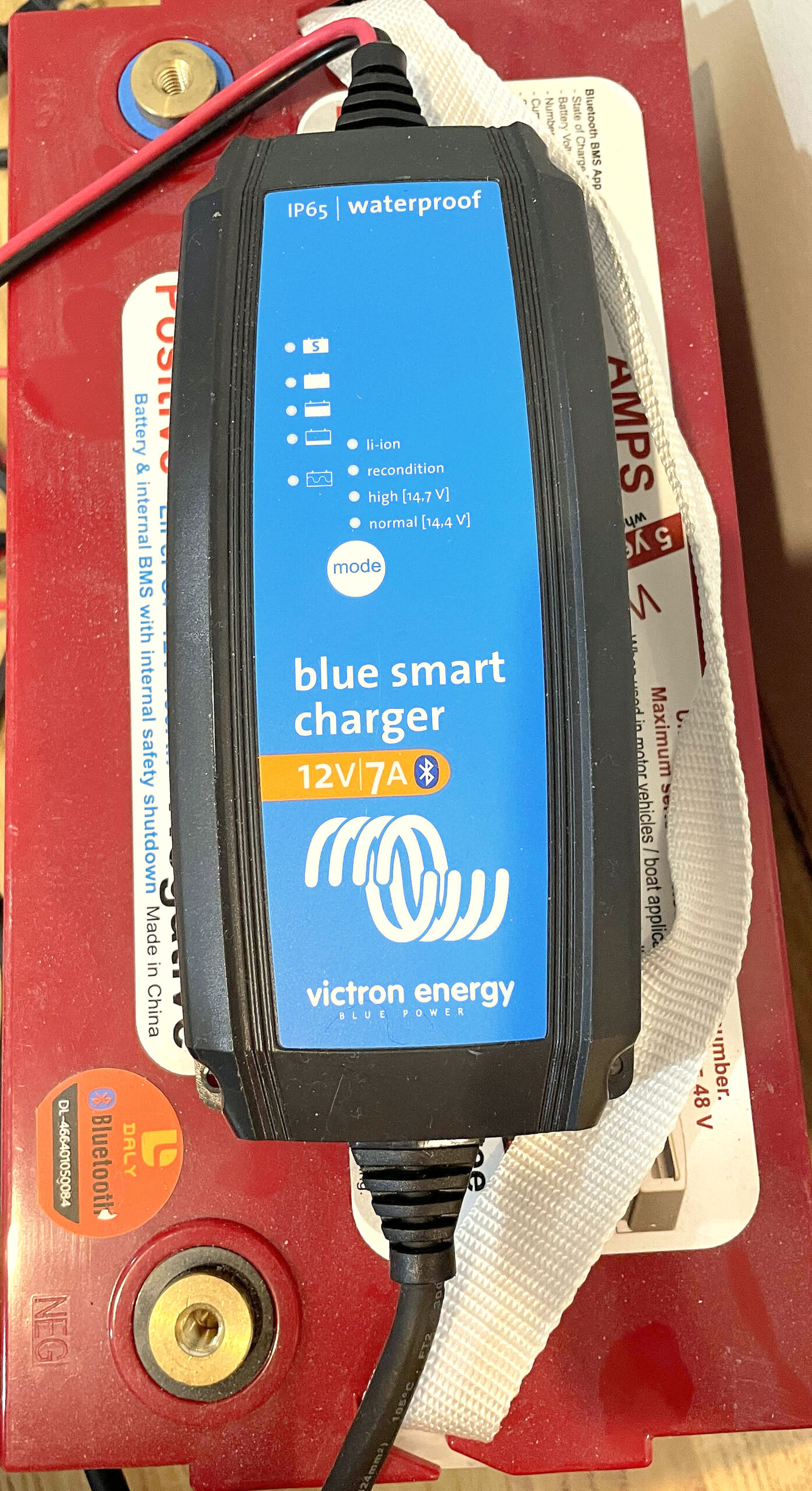

The batteries are new with a new trickle charger on them so they shouldnt be the issue.
Batttery charging and charging systems are a whole new field for the new boat owner/sailor.
Here is a link to some light reading about the subject. :yikes:

I suspect the new batteries I had didn't have quite the charge I needed. After a day on the trickle charger the engine started up on second attempt. That's my theory anyway.
Good in theory. :) In practice, not so much. Trickle chargers, those that provide ~1a of charge current are designed to off set the normal self-discharge rate of about ~1a per day. If you do the math, they don't do much for recharging a battery.
FLA batteries want a strong charge at 10% to 20% of their rated amphour capacity, in practice they do best with a 3 stage charger in the 15-20 a range. It is no coincidence that Victron makes 18a chargers.
