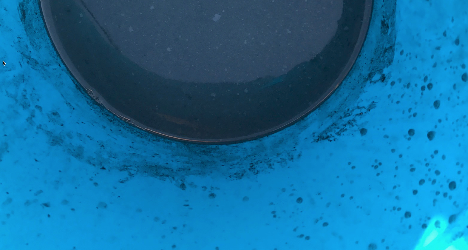

Thanks to both for thoughtful replies. Does not run rough. Bottom painted and prop cleaned about 30 days ago. Impeller replaced and was not deteriorated. Kept in freshwater. This boat had a broken mast... took the yard longer than normal to sleeve (about 2 months), so it has just been sitting at the dock. Every couple of weeks I would run it, first cranking without starting to distribute oil, then starting, running for a few minutes at low speed, then high speed in gear for 5-10 minutes as I know the engine needs a load for proper maintenance. Right now this is a major source of lake pollution. I always look at exhaust after starting to assure water flow, which is why I know it went from clear to dark/dirty. Put a 1/2 gallon of exhaust water in a bucket and photograhed it. Very little oil on top. see photo.
Was going to run for an hour tonight, but afteer 10 minutes water temp alarm went off.

Thanks for your reply. Color in the lake is almost black. Color of water in bucket picture above is what is pouring out of the exhaust. Am looking now for a new diesel fuel filter. Will check for blow by. Thanks again. Jim
