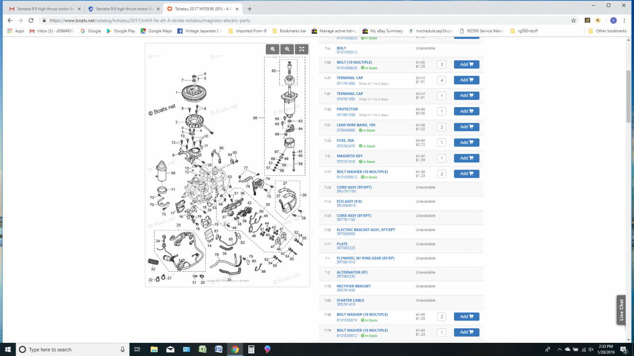

Wrong Gunni, I have a few here and the parts list calls out the ECU. Why do you say that??

This version of the Tohatsu continues to use a mechanical fuel pump, not an electric pump, so that a battery is not required to start it. Maybe some genius can explain how an outboard that has no battery is going to power an ECU at start?

It has a ECU and an electrical high pressure pump, ??? You generate enough energy to power the ECU, electric fuel pump, and injectors with a short pull of the rope. The mechanical pump is a low pressure pump that just supplies low pressure fuel to the vapor separation tank, the electric high pressure pump is inside of the tank. The 15hp EFI I had started very easy, very short pull. The "no battery" EFI system is the same as the conventional EFI system used by all the manufacturers, only diff is the low startup energy required. I assume everyone will eventually use this system, big improvement over the carb system for small motors.

The 9.9hp motor doesn’t use an electric pump, the fuel tank is a simple small outboard fuel tank, the same as used in all other small Tohatsu outboards. There is no fuel pump in the fuel tank. You must be talking about some other motor.
Sorry bud, there is no electric fuel pump on the 9.9 Tohatsu, and they don’t require one in the fuel tank. You should go check one out, they are pretty basic.

Come on , Gunni. Al has pictures and a pretty athuritative description, he being in the business. You never state your source or you your source of "facts", so it all sounds like only opinions. Al holds the trump card. Like Dave, who is a previous dealer, and people assume he lknows of what he speaks.

Ron, you might want to study ol’ Al’s engine electrical diagram before weighing in here. Maybe you can get him to tell you where the electric fuel pump is located on the 9.9 Tohatsu EFI! Me, I own a Tohatsu 9.8 and have been shopping the 9.9 EFI since it came out.

First, the Tohatsu 8 and 9.9 to include the Nissan and Mercury engines built by Tohatsu had a mechanical fuel pump, not an electric fuel pump seen on the larger engines unless things have changed since 2010. I suggest a break down diagram of the particular engine by year, model and serial number to answer that question for sure.
