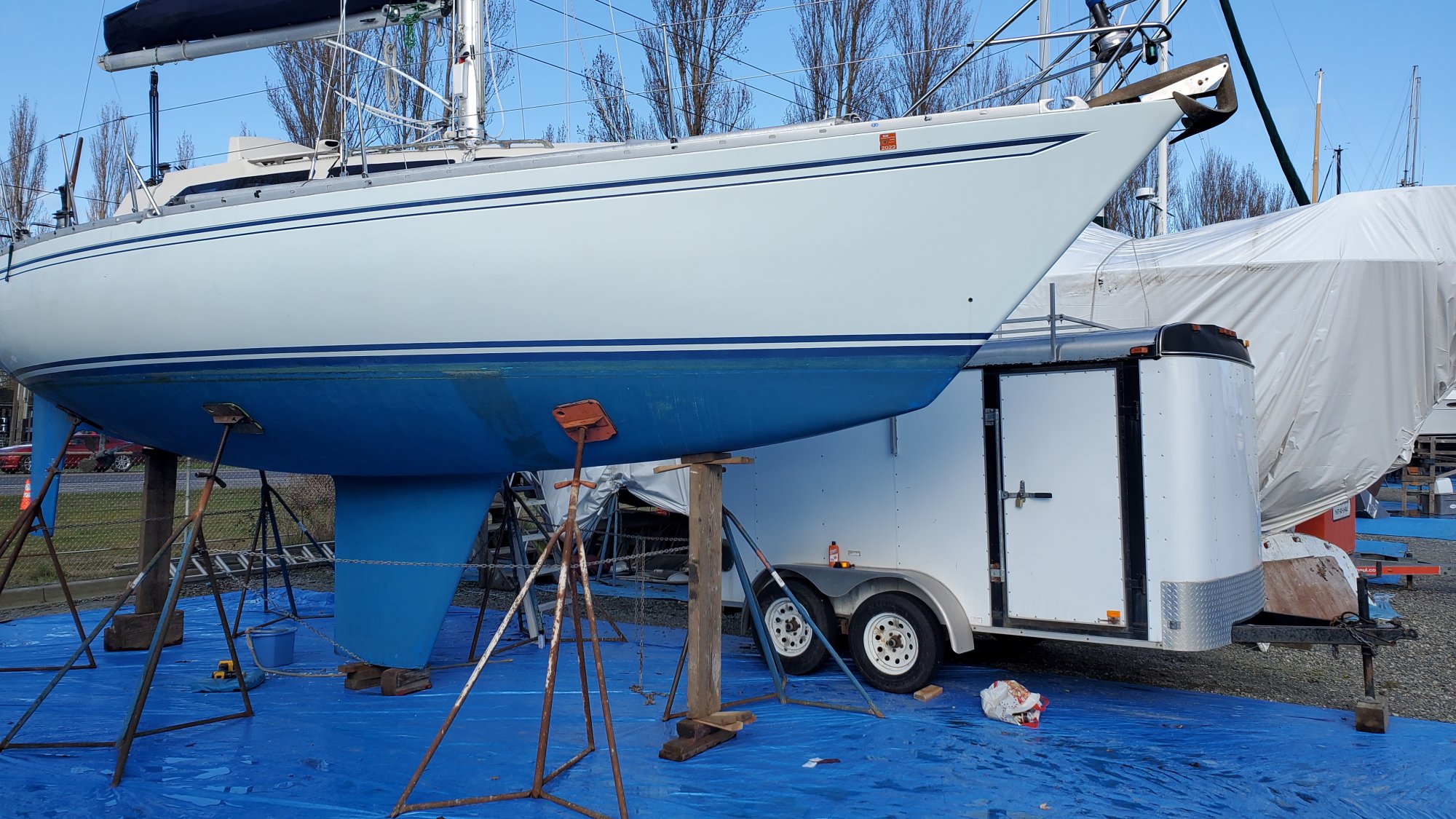

Is the 33' (1978) stable while resting on the keel? Keel resting on a rigid level surface(tidal grid). Moored securely to two piles alongside. See photo. Stated another way, is the boat stable fore and aft while sitting on the the keel.

The boat, a Yahama 33 has a Monohull fin keel. Depending on the lengths and base of the keel, it can rest on it but will not be stable. You would need to tie it up to a grid, and lean it against the pier, but it could slide out and be hanging from the ties. You would want to some how stabilize the keel perhaps using strong ropes tieing the keel to the pier to stop it from sliding.

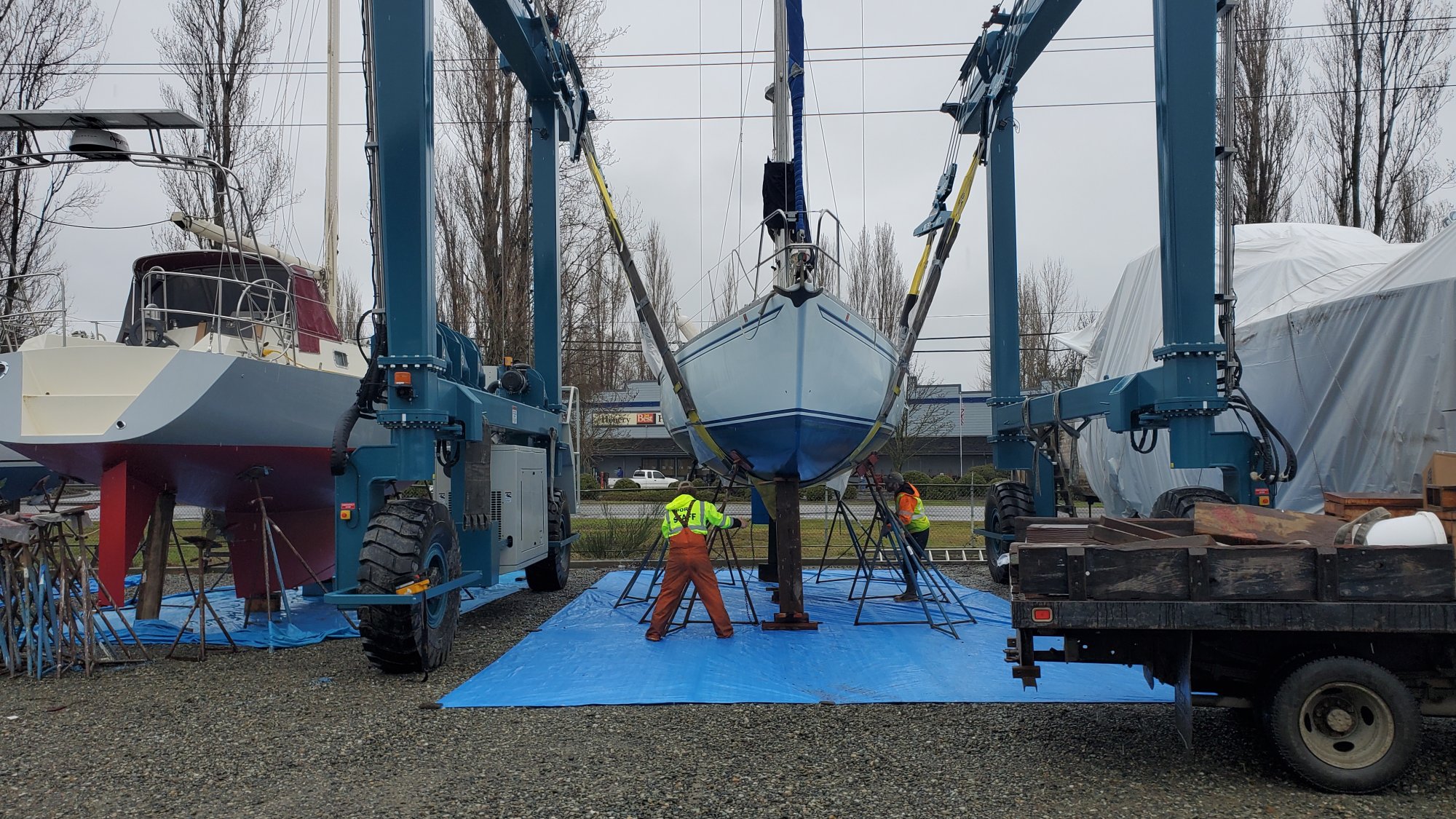

If you lift the boat and set it on the hard, the yard will locate braces (jack stands) to hold the hull steady. They might use 9 or more braces to stablize the hull.

How ya gonna haul out if you don't rest on the keel? The jack stands only provide lateral support, all the weight is on the keel.
The hull on the Y-33 is over an inch thick below the waterline, with a grid structure inside. Should be fine. I lived on it for a couple of weeks last spring.
Edit: note the substantial fore and aft shoring. I don't know if I'd try it on a tidal grid, which was the original question. Let us know how it goes.:biggrin:

So, had a visit to the to the tidal grid. No Drama. Boat seemed quite stable (fore and aft) and seemed happy lashed firmly to the 2 piles. Your results may vary.;) Cleaned growth in thru hulls and knotmeter, cleaned mussels and barnacles on prop and shaft, new zincs, and serviced the MaxProp. No bottom cleaning or anti fouling paint (not allowed).
Noticed my keel is a different shape than the drawing attached. Is that a difference between the iron and optional lead keel?

I have the tall rig with lead keel. Keel looks like the diagram, not the photo. I have some bottom pictures from an early standard rig, but I'm a week away from retrieving them and I'm not sure if I have a photo of the keel profile.
