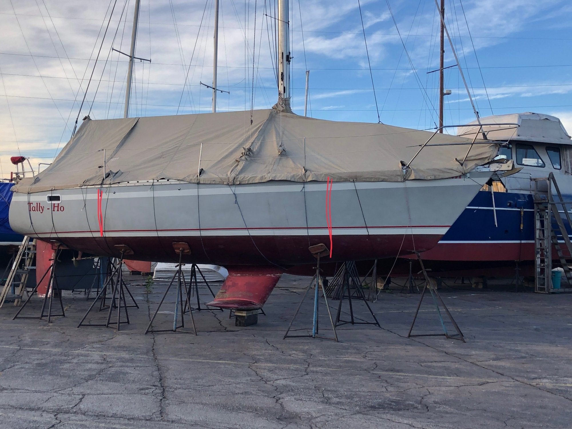

Does anyone have an idea where to place the slings on the Y33? I've not seen anything in the manual.

Normally, try to put slings where you have bulkheads, but that assumes you have them somewhere near the locations where your slings make sense (under the bow and under the stern (away from your shaft).
i marked where mine go on my O’Day 322, just as reference….
Really, probably won’t make too much difference since the boat won’t be in the slings too long.
