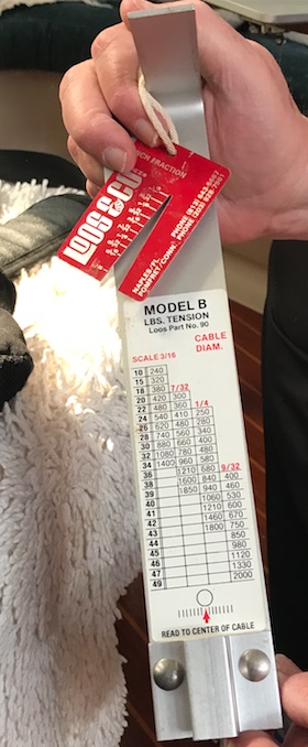

And this strange object, which puzzled me at first. Then remembering a video of how to set the tension of you standing rigging from a SBO contributor.:clap:
It may not offset my $$$ for a new Condenser unit, but at least something to smile about. Plus the weather was perfect today and sailing fever is rising.:)

That Loos gauge is worth about $100. I have to have 2 to cover all of my wire sizes.

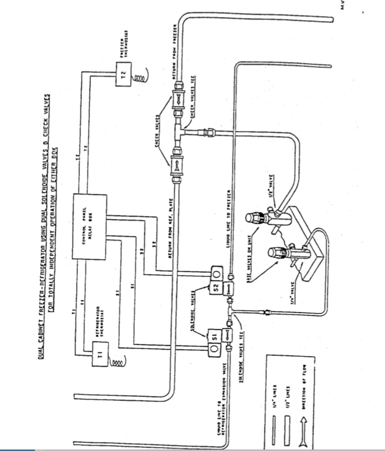

We checked each thermostat. Both worked, thus verifying the Dual Holdover plate solenoids and check valves worked.

Dual Holdover Plates..
I even asked both Techs...
Any possibility that one of the Check valves were leaking Discharge to Suction?
Ans: Never had that happen... from both.
