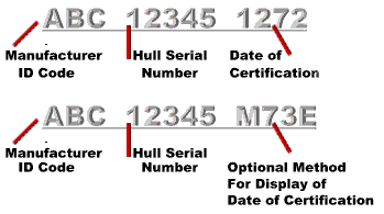

Look carefully on the upper starboard corner of your stern. The HIN number should be there. Perhaps under a layer of paint.
The attachment is a look at the numbering system.
