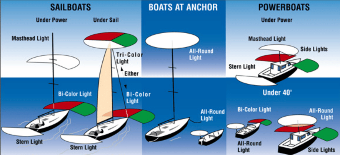

First, the use of masthead tri-colors are not without controversy. Perhaps the biggest issue is the light is located above where most people look for navigation, i.e. most look for Nav lights closer to the horizon and water than 20 ft up. The advantage to tri-colors are 2, off shore the light will be visible long before a deck light is visible and with one bulb there is less current drain than with 3 bulbs in deck lighting. The latter advantage is no longer there as LED lights draw so little current.
Stick with bow red/green nav lights with a stern light aft and a "steaming light" on the mast for use with motoring. We sailors refer to the forward facing white light used when motoring as the steaming light. The COLREGS and the USCG Regs refer to it as masthead light, confusing? Yes. If you plan to anchor out, then a dedicated all-around white light at the top of the mast is needed. All of the navigation lights, regardless of position must be USCG approved.

<sigh> I'll go through it again. For sailing I'm going to have a 135 stern light at the top of the mast plus separated red/green.
When under power I'm going to have a 135 stern light mounted on top of the rudder and use the 225 white on top of the mast. When I'm under power the rudder will almost always be centered. Significant deflections will be momentary. Anchored, just the 135 and the 225 at the top of the mast.
My thought was that as long as I'm going to wind up with two combination stern/anchor lights if I mount one on the rudder instead of the standard stern light, I can use the forward-facing 225 as a cockpit light. Assume I'll have enough wires, switches, and diodes to be able to illuminate the correct combinations for sail or power with the contemplated cockpit light on its own switched circuit.
For a 16' sailboat the requirements are these: Under sail, red/green in one light or separate; no forward white required; 135 white stern without height requirement
Power: red/green as above; 225 forward white at least one meter above red/green; 135 white stern, any height. My arrangement will have the 225 white on top of the mast,
not mid-mast as a steaming light. The regulations do not specify a maximum elevation
above the red/green, only a minimum. I'll be legal and if I use the second 135/225 on
top of the rudder, I'll have a cockpit to find the potato chip I dropped.

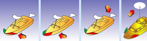

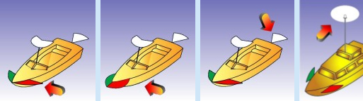

Well, why? If you see the red and green you shouldn't be seeing the stern. If you see white and no red or green you are looking at the stern.
Navigation Lights for Powerboats
Power driven vessels underway shall exhibit a masthead light forward, sidelights and a stern light. Vessels less than 12 meters in length may exhibit an all around white light and side lights.
See the image on the right
The Compac 16 has a bridge clearance of 21 or 22 feet so your not looking up at at 40. From your boat the top of his mast is probably only 10-15 feet higher than your eye level. :)
From the side, you would be seeing a red or green, and then the white straight above it. That is for a power boat, small, but not a sail boat. That's the light constellation he's talking about under sail. Then, under motor, to use a non-stationary light mounted on his rudder and the steaming light at his last head.
Given where he has mounted his red and green, I haven't even talked about the concern - if looking straight at the bow of this boat - do you see both red and green lights? Because given their location - it's quite possible these lights are not visible from straight ahead...
