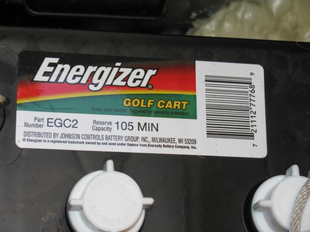

6 volt golf cart batteries from Sams.. (at least in S. Denver). I think different stores might carry a different brand/manufacture.
Thanks,
