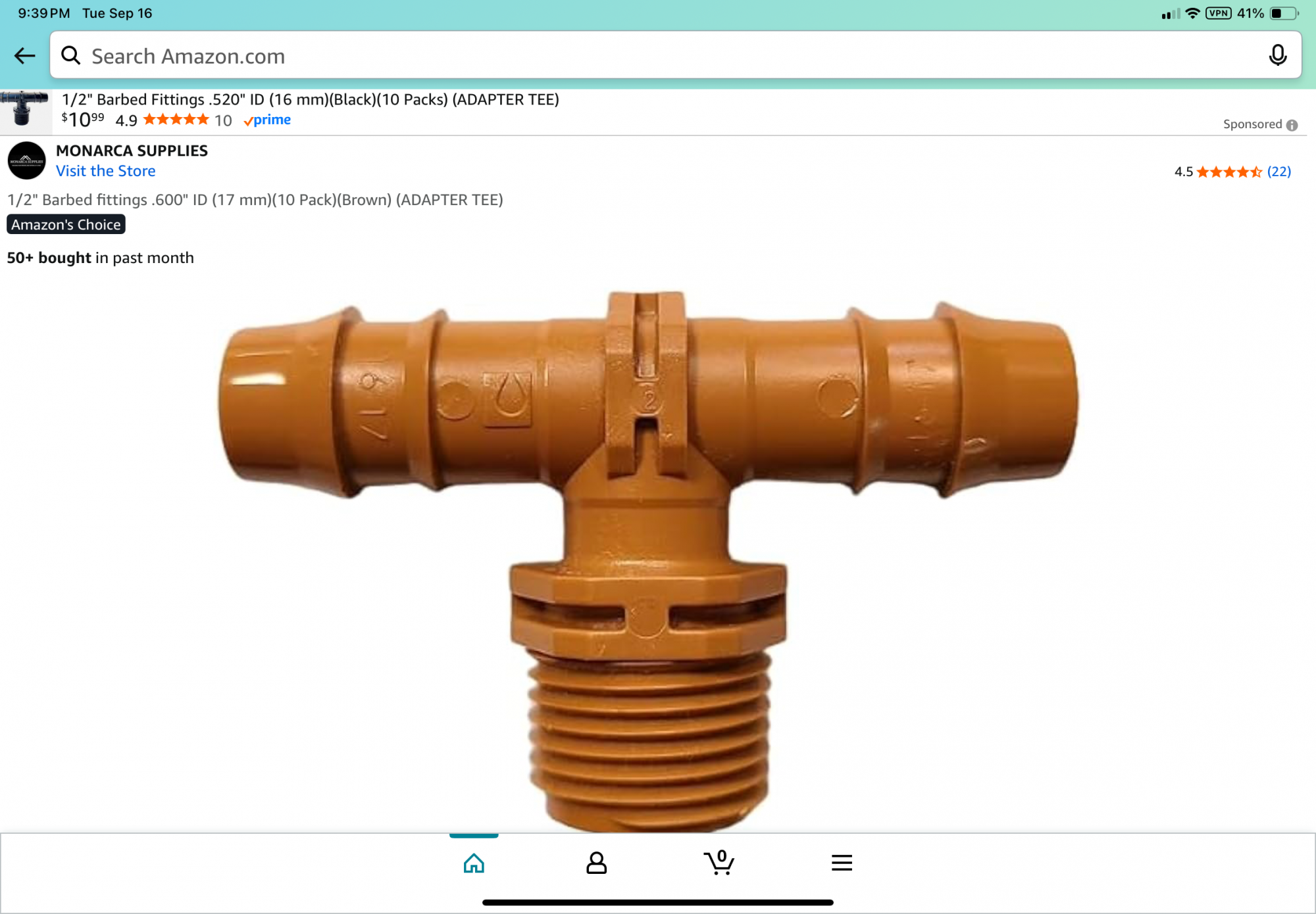

What I would do is put a small T with a hose thread on one branch of the T. This is a small T and you should be able to find a p,ace for it as close to the thru hull as possible.
Put a cap on the hose thread to cap it. Then, when is is time to winterize, close the thruhull, put a short piece of hose on the hose fitting and stick the other end in a gallon of pink AF. Once you winterize the toilet, replace the cap and open the thru hull…all done.
It would important to find a robust T fitting and cap if this will be cut in below the water line.

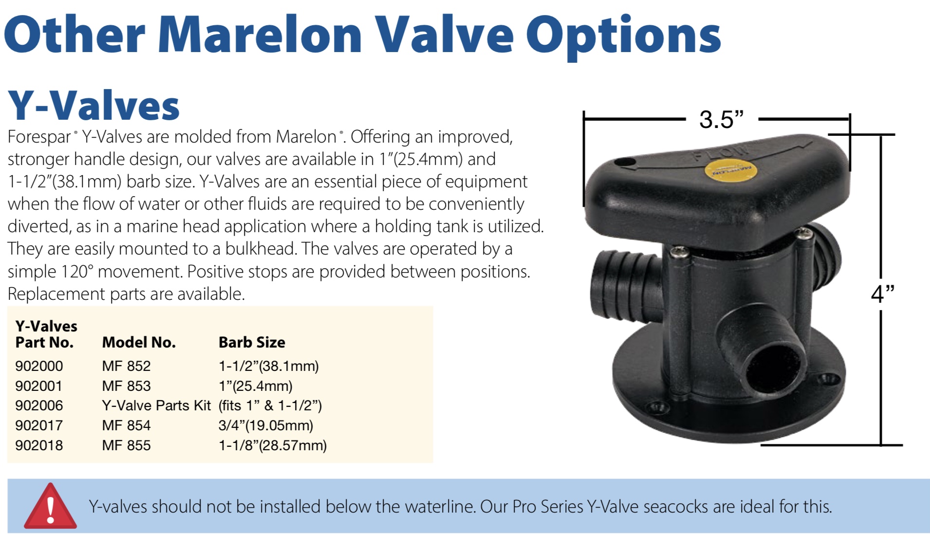

I Thank you for your help. I saw this Forespar Valve at West Marine (only it was 1.5 inch size) not in my 3/4 inch size. But it seems to be a solution I can easily add to the intake hose.
moving a y-valve handle sure beats taking a hose on and off a thru-hull.
I can do as Dalliance suggested and leave the Winterizing Hose in place until needed. What do you think? Would this make the Winterizing Hose to long to be effective and to long a draw to pump antifreeze into the toilet?

My concern with this valve is it doesn’t have 1 threaded end to be able to cap it off when not in use. Search goes on.
