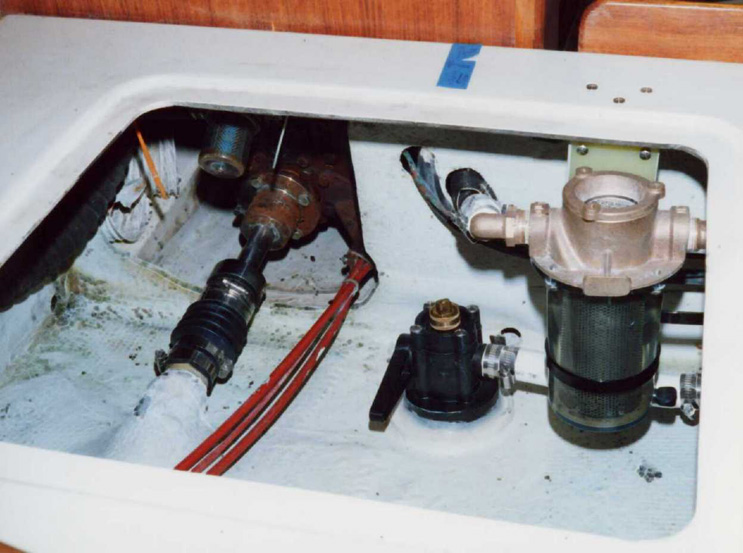

I have installed a "T" fitting just above each of my inlet thru-hulls. Each "T" has valve attached to it. See my photo. This simplifies winterizing a great deal. I have an 18" piece of hose with a male threaded fitting on the end. I screw it into the "T'd" valve of the ciruit to be winterized and since all circuits are the same one piece of hose is all I need. This picture shows the back of the engine compartment and the upper portion of the thru-hull, "T'd" valve and strainer basket to the right To winterize I attach the hose to the "T'd" valve and dip the other end into a bucket of antifreeze. I open the main thru-hull (if boats in the water) and start the motor. Once it's warm I open the "T'd" valve and close the main thru-hull. The bucket drains and I kill the engine. No hoses to pull off each year. It's worked great for many many years. All the other systems aboard are approached the same way. I do make it a point to check these for signs of wear or cracking periodically.
Please keep in the back of your mind that you've added multiple below water connections, 4 additional, a brass valve not bronze that could become anodic, and at least two plastic fittings that could be PVC, which is advised against for below water connections. Also some of those connections only have one hose clamp.. Convenient yes, but adds a lot of potential for failure too.

OK, OK so there's room for improvement. I do like the convenience but do see your points MS and Gunni. Thanks for your imput.
Feb 6, 1998
11,772
A more robust method is to use a bronze tee and bronze nipple coming directly off the strainer (not the seacock). This is ONLY if you have a robust solid bronze strainer, which you do. If your strainer is plastic please don't use this method.
Off the tee will be another bronze nipple to a bronze ball valve. No additional hose clamps to fail and all hard piped with solid bronze. Groco sells BRONZE nipples and they are the ONLY source for real bronze nipples I know of. Don't fall prey to brass below the waterline it can be very dangerous... Red brass is better but is still not bronze.
Off the strainer Inlet = bronze close nipple, bronze tee, bronze sweep ell, J2006 hose, seacock (hose double clamped with AWAB style non-perforated clamps)
Off the tee = bronze close nipple, bronze ball valve (remove handle when not in use)
Or = Once per year simply loosen two hose clamps, pull the hose of strainer inlet and replace with hose from bucket, takes about 45 seconds....

I found a picture of our engine intake from a few years ago. Picture note: the short hose from from the thruhull goes under the Groco strainer, thru a couple of elbows, and into the top. This does not show well in the photo.

LB, it looks like your hose fitting is also brass, not marine bronze.
Probably is. However, No liquid ever sits in that "hose fitting" unless pink antifreeze is going thru it.
The little bronze plug I put into the top is really just for cosmetics.
On the whole, it's one of the cooler Marlon thru hull devices that Forespar makes, IMHO.

Aw, I see, it is a three-way valve. How long have you had that Marelon thru-hull, and how is working out for you? What is your maintenance schedule?
We put in all "new design" Forespar thruhulls in '02. Only maintenance is to open/close the valves regularly.
No problems, but I should note that as of that year, Forespar had not yet solved the problem of the ball material being very slightly hydroscopic.... so they are still hard to operate, and I ascribe that to the ball material slightly swelling.
However, these new valves do allow you to back off the screws from the top of the split body and free them up.
Considering that we have no worries about electrolysis, I like these thruhulls.
