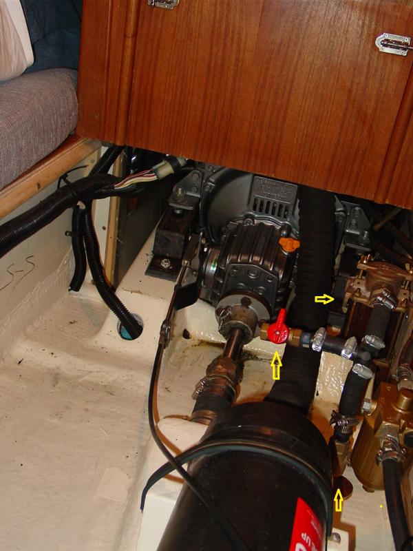

I have installed a "T" fitting just above each of my inlet thru-hulls. Each "T" has valve attached to it. See my photo. This simplifies winterizing a great deal. I have an 18" piece of hose with a male threaded fitting on the end. I screw it into the "T'd" valve of the ciruit to be winterized and since all circuits are the same one piece of hose is all I need. This picture shows the back of the engine compartment and the upper portion of the thru-hull, "T'd" valve and strainer basket to the right To winterize I attach the hose to the "T'd" valve and dip the other end into a bucket of antifreeze. I open the main thru-hull (if boats in the water) and start the motor. Once it's warm I open the "T'd" valve and close the main thru-hull. The bucket drains and I kill the engine. No hoses to pull off each year. It's worked great for many many years. All the other systems aboard are approached the same way. I do make it a point to check these for signs of wear or cracking periodically.
