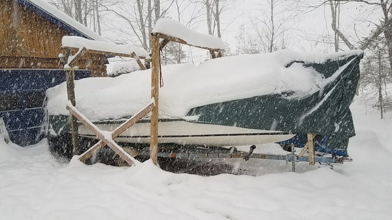

Welcome to SBO. I hope your sailing adventures are just getting started. I'm sure all of us are looking forward to following your career as a sailor. The Daysailor II is a very nice boat for anyone. You are pretty lucky. My boat is a O'Day Mariner 19. I keep it under a tarp, just a simple, WalMart bought, tarp that covers the whole length with a few feet overhang. I live in NH, so Winters are pretty harsh. 20171225_083407.jpg
Shemandr gave you excellent advice. Keep the tarp tight to prevent puddling. Also, do the best you can to dry your boat out before Winter sets in.
It's great to hear from the up and coming generation of sailors. Welcome.
