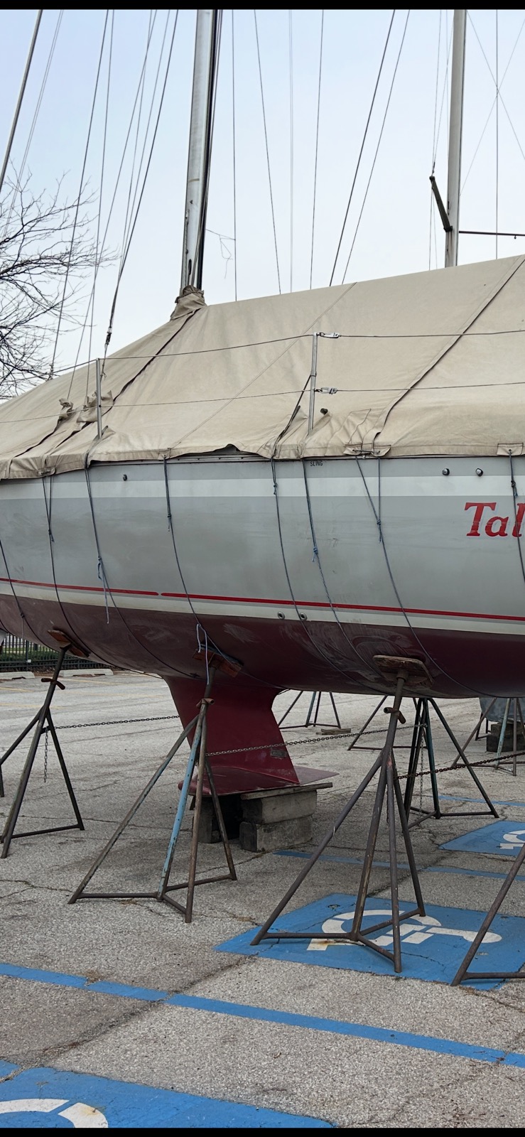

I have been covering Tally Ho since the 2nd season I had her (about 9:years now). First year I used tarps and a wooden frame…real pain in the arse.
Then I bought a canvas cover and have used it ever since. Works great, but if I were to do it again, I think I would get the edges a little longer. In some places, it comes down over the toe rail a decent amount. In other areas, not so much. But that does provide plenty of ventilation:cool:
i have seen several boats blown over in my marina (we are in the Windy City after all). I think all of them did not have a cover. So I am not too sure that the cover creates that much more tendency for the boat to blow over.
i chose to cover my boat because I don’t think the freeze/thaw cycles are good for a,”Good Old Boat” like Tally Ho. Plus, it helps keep any deck leaks to a minimum since most water is shed off the cover and onto the ground. Snow and ice piling up on my deck is something I want to avoid if I can.

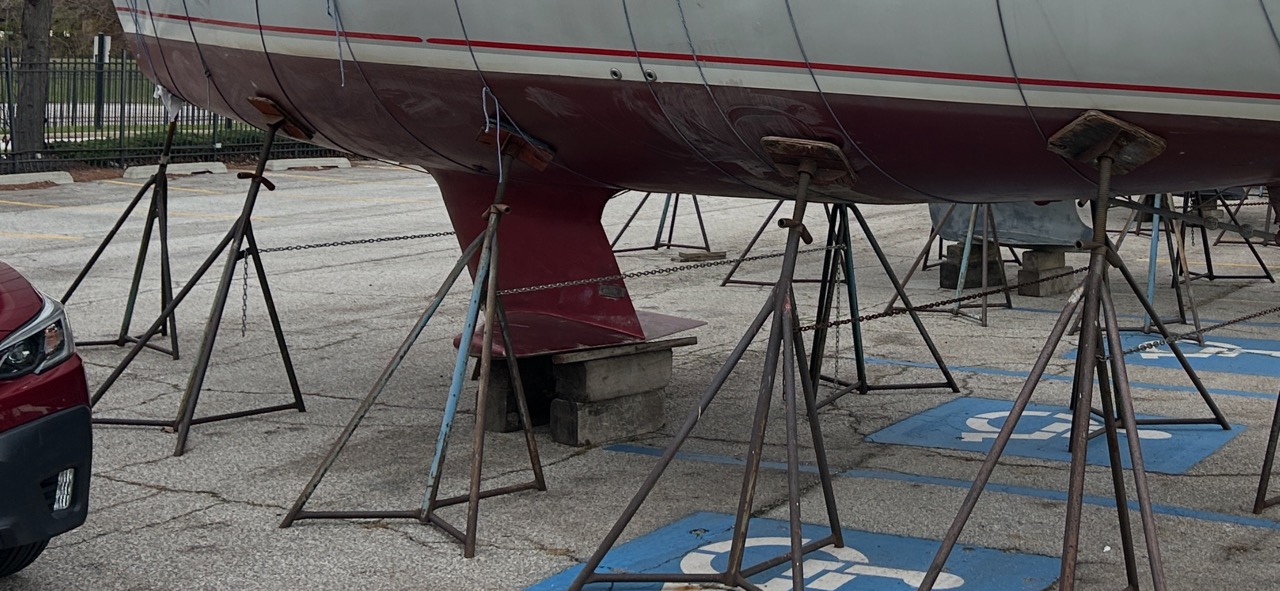

@Tally Ho I notice your keel is only blocked in one place while your neighbor has it blocked in two places. Is there a reason for the single block, single blocking was one of the causes of my boat falling over. Oh, and do you have Handicap sticker for your boat?
Hey Dave,
We used 2 blocks under the keel for years (the yard guys). It has always been difficult because the wing keel is angled quite a bit on the underneath side. So one year, I said to them, just skip the second block. All the weight is centered on the one spot on the keel anyway”.
Luckily the boat stayed on the stands over that winter, but in the spring, I saw a boat that had been on blocks for a few years had fallen over…the blocks it was was on had rotted away.
So, yes, I should have had 2 sets of blocks under the keel (there are 2 blocks now).
