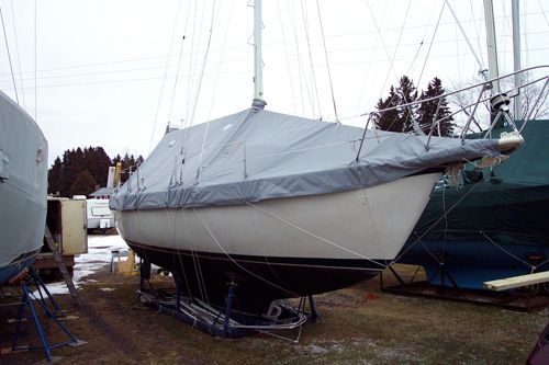

In Chicago area...so a bit snowy here...
this cover has worked well for about 5 years so far...
I got this one from “The Canvas Store”.
Greg

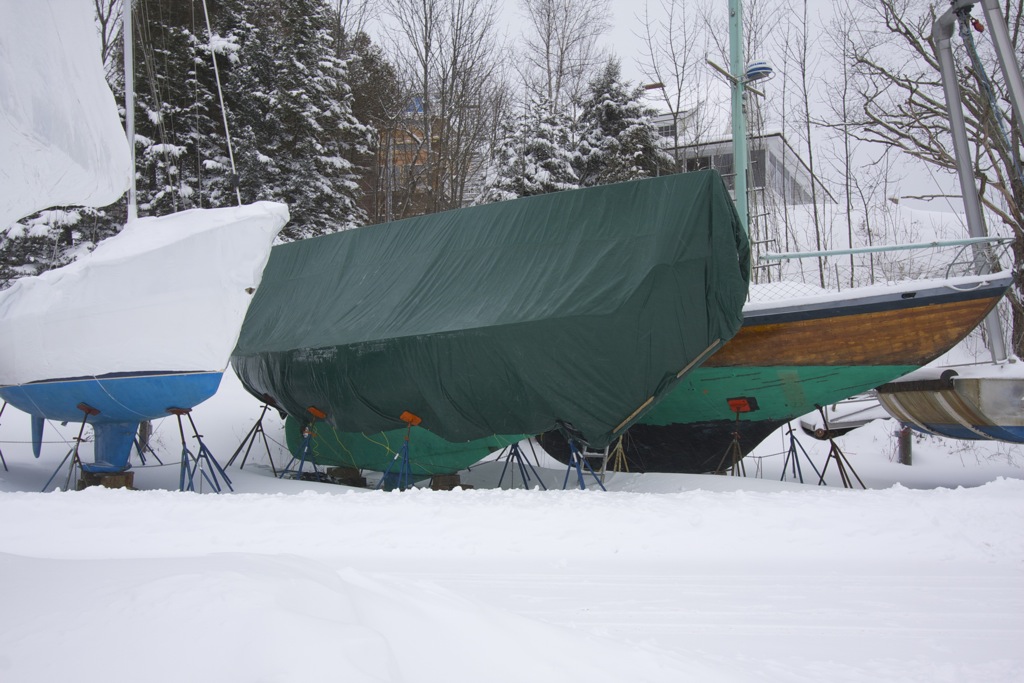

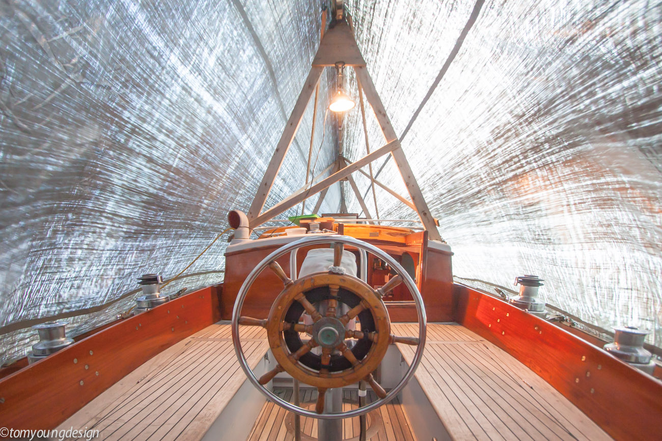

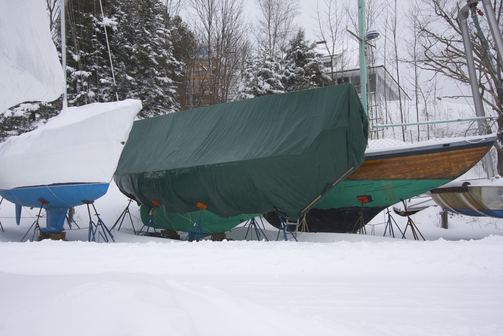

This works for me: 2X6" high ridge supported by 3 A frames and a 30' X 50' plastic tarp.
Mast up, I'd go shrinkwrap and hope you could recycle it.
I live nearby and can keep an eye on it. I've never lost a tarp in over 10 winters on the coast of Maine but I think I'm the exception. :) It helps me in the spring allowing some work to be done in poor weather. It keeps the boat bone dry and well ventilated (I leave all the hatches open below and open a small vent on each end).
The only cover that has no compromises, is a building.

ToddS
Sep 11, 2017
248
Beneteau 373 Cape Cod
That looks to have good pitch for discarding snowfall, but having the cover underneath the stand bases would give me a big cause for pause, although it is difficult to explain exactly why...same feeling if my boat was on either side...
My boat yard has a strict "nothing attaches to the stands" policy... can't tie a tarp to them... nothing... understandably. I'm not sure if clamping the tarp between the stand and the hull technically counts as "attaches to"... but I wouldn't do that.
TomY
Alden Forum Moderator
Jun 22, 2004
2,769
I'd agree, if I haven't been doing it for so long. :)
I tighten the poppits and capture the tarp against the hull. The stands are chained together in 3 pairs. Then I lash the tarp grommits from side to side under the keel.
Each end is sealed with a 4 - 6' 2x4 rolled up inside the excess tarp material, then another is place on the outside of the wrapped 2x, and screwed into it to sandwich - secure the ends.
I rarely loose a single grommet over the winter which is unheard of with plastic tarps.
I've never had the stands loosen due to the tarp. And I check all the stands in the yard and mine are the ones that need the least adjusting. We get a lot of wind right on the waters edge. Go figure.
Jun 14, 2010
2,487
Not difficult at all... more likely to slip. Good eye.
(PS - not being critical of Tom. Utmost respect. Sometimes it just helps to have another eye on something.)

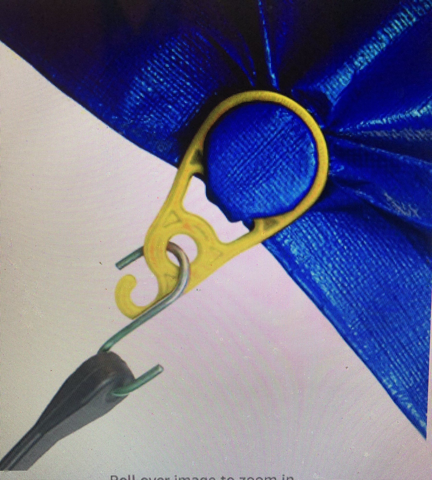

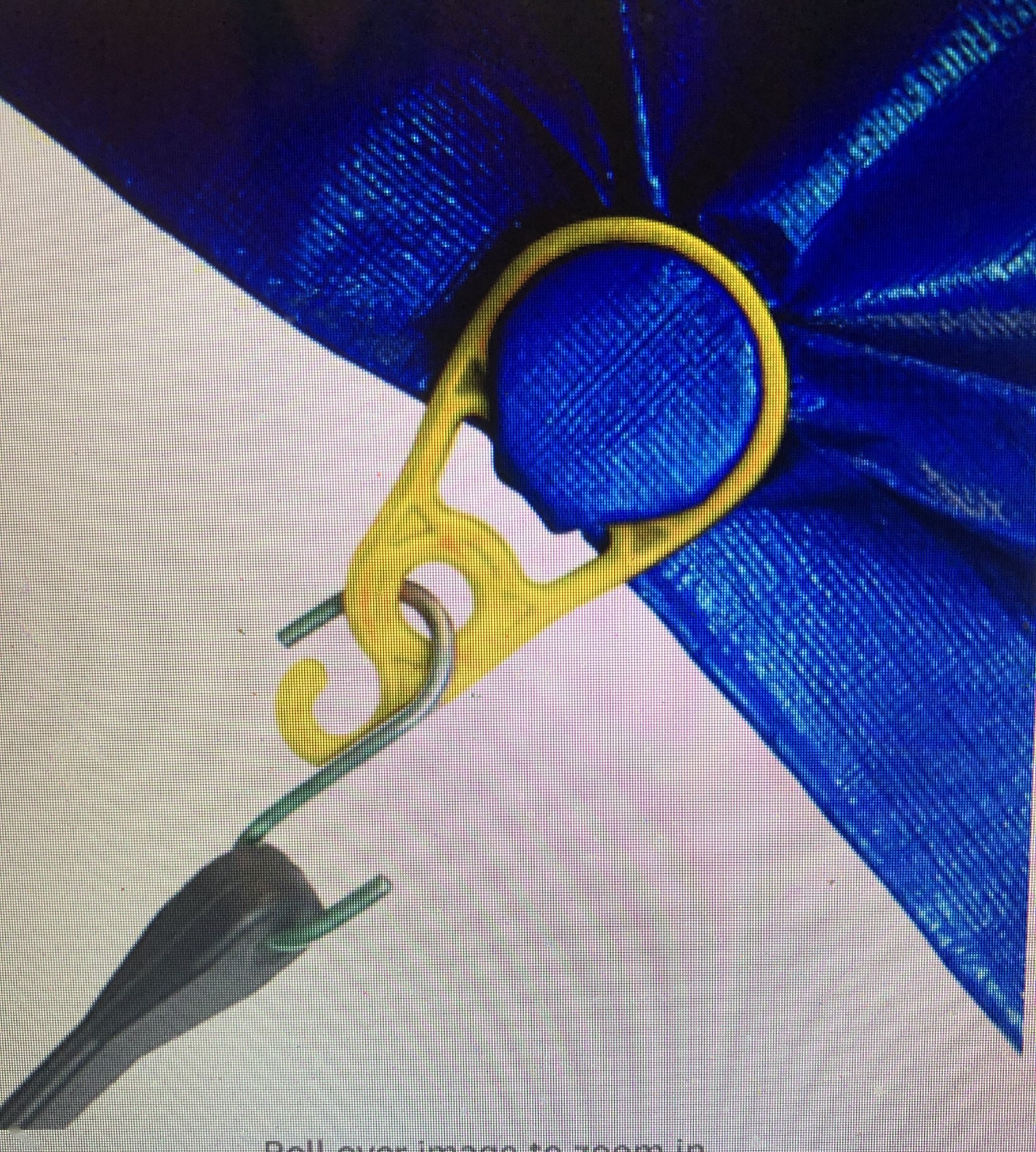

When I tar
ped my boat I used these.. Slick as all get out.. A star shaped disc is placed in a gather of tarp where YOU want purchase. Then the pinch ring goes over the gather and secures the tarp.
Jun 14, 2010
2,487
When I tarView attachment 185829ped my boat I used these.. Slick as all get out.. A star shaped disc is placed in a gather of tarp where YOU want purchase. Then the pinch ring goes over the gather and secures the tarp.
Technology as old as the garter belt ;)
You might think it’s new if you grew up in the pantyhose era. :facepalm:
