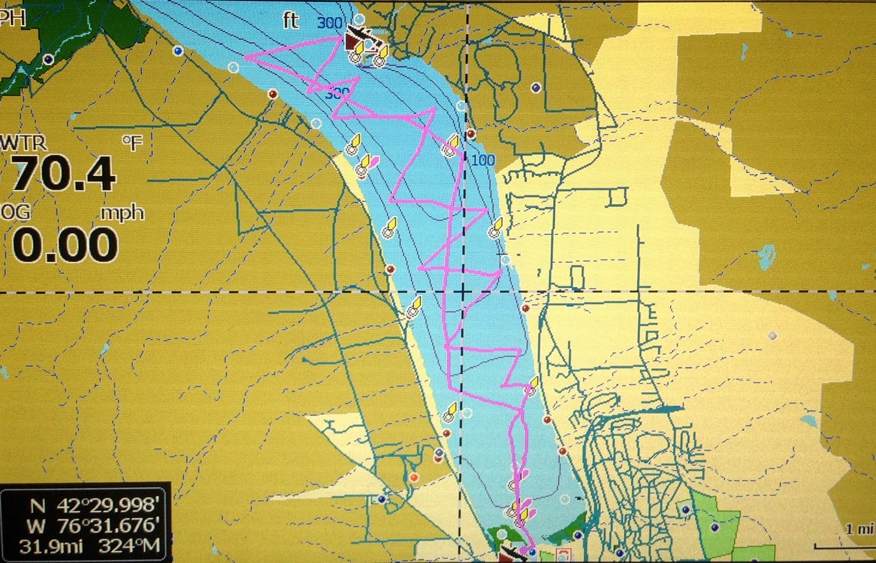

Helene and I want to begin exploring some new places, and we do not have time to cruise to them. We also do not want the work of setting up the boat if we trailer it there. Perhaps we will get another C22. The thing is, Helene likes the boats, but she never fell in love with sailing. Maybe she would if we could sail all day in the ocean. The lake is a lot of work! The faster you go, the more you tack. Anyway, I have done both sail and power my whole life, so I am good with either.

Roger that Mate! LOL... The faster you go, the more you tack. Don’t I know that:
