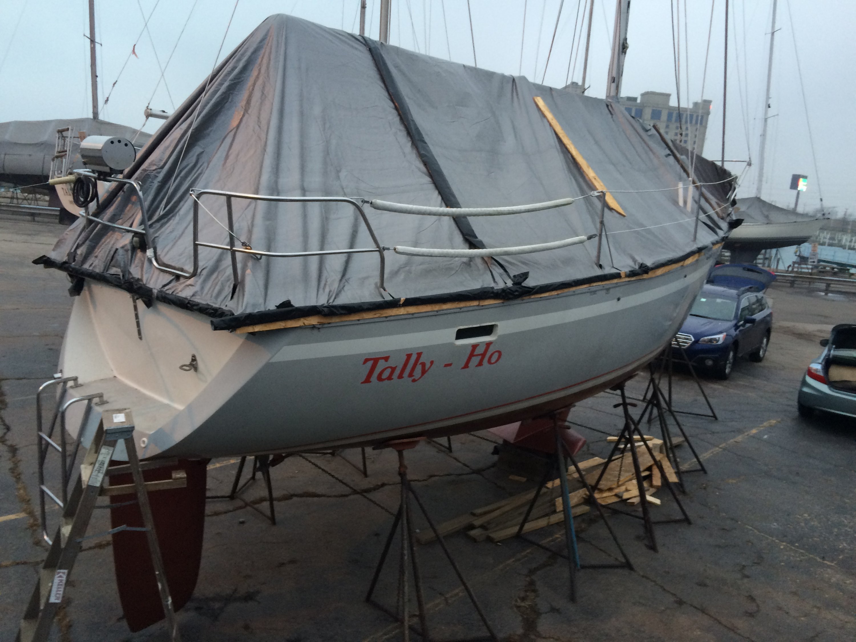

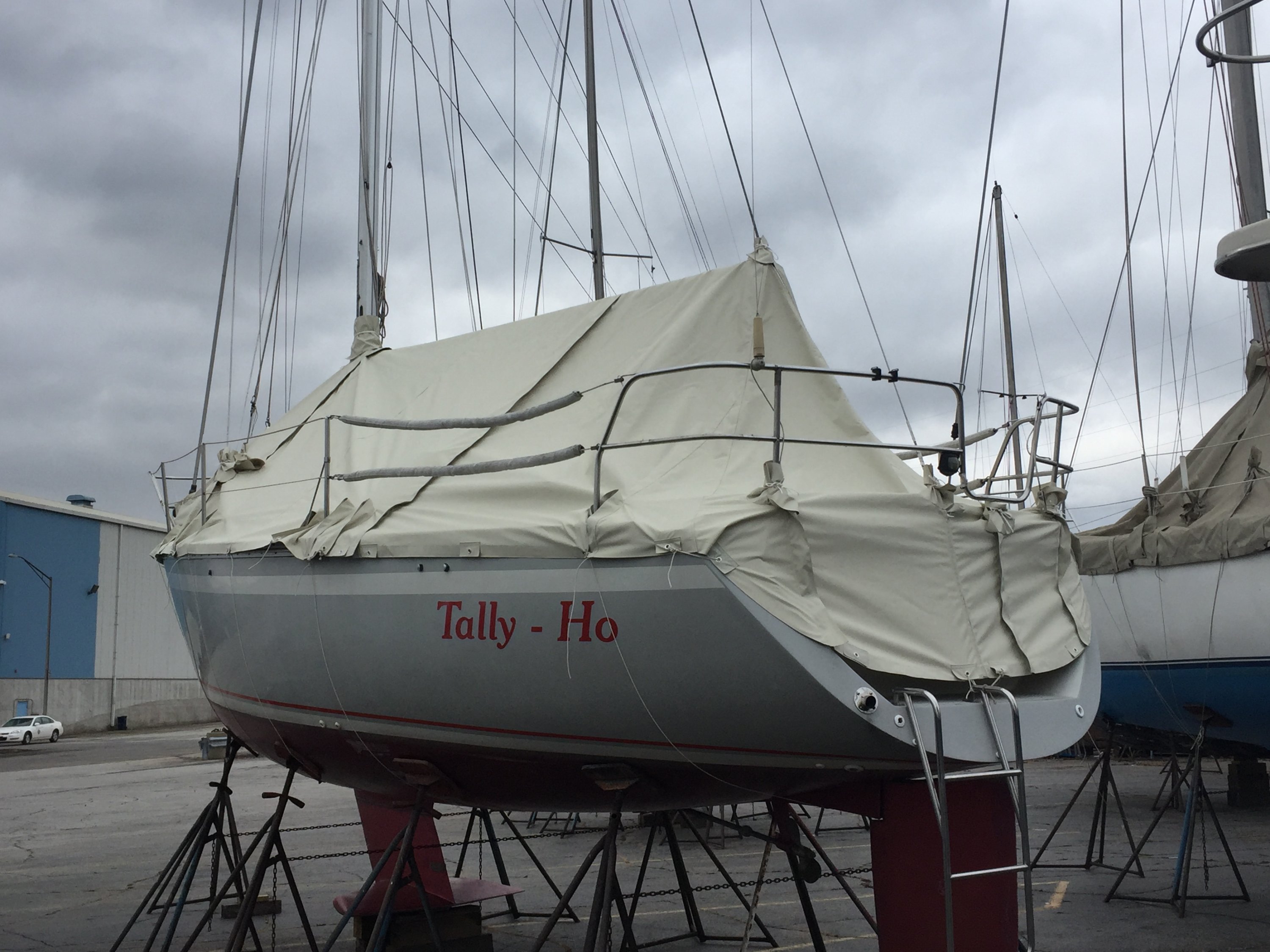

I tried the tarp over home made frame the 1st year I had my O'Day 322 on the hard. A real pain in the @ss to "build" it the first time, and it was butt ugly. The tarps were pretty much shot after a long windy, icey, snowy winter in Chicago.
Ordered a Top Gun cover from The Canvas Shop rep at the Chicago boat show and used it last winter. The cover comes in 3 pieces that zip together, does not require any frame, and is custom made for the boat.
Mainsail would not like it I imagine because the tie downs will rub on the hull. But it worked well for me last year. Haven't covered the boat yet this year, but I can do it myself if necessary in a couple of hours.
