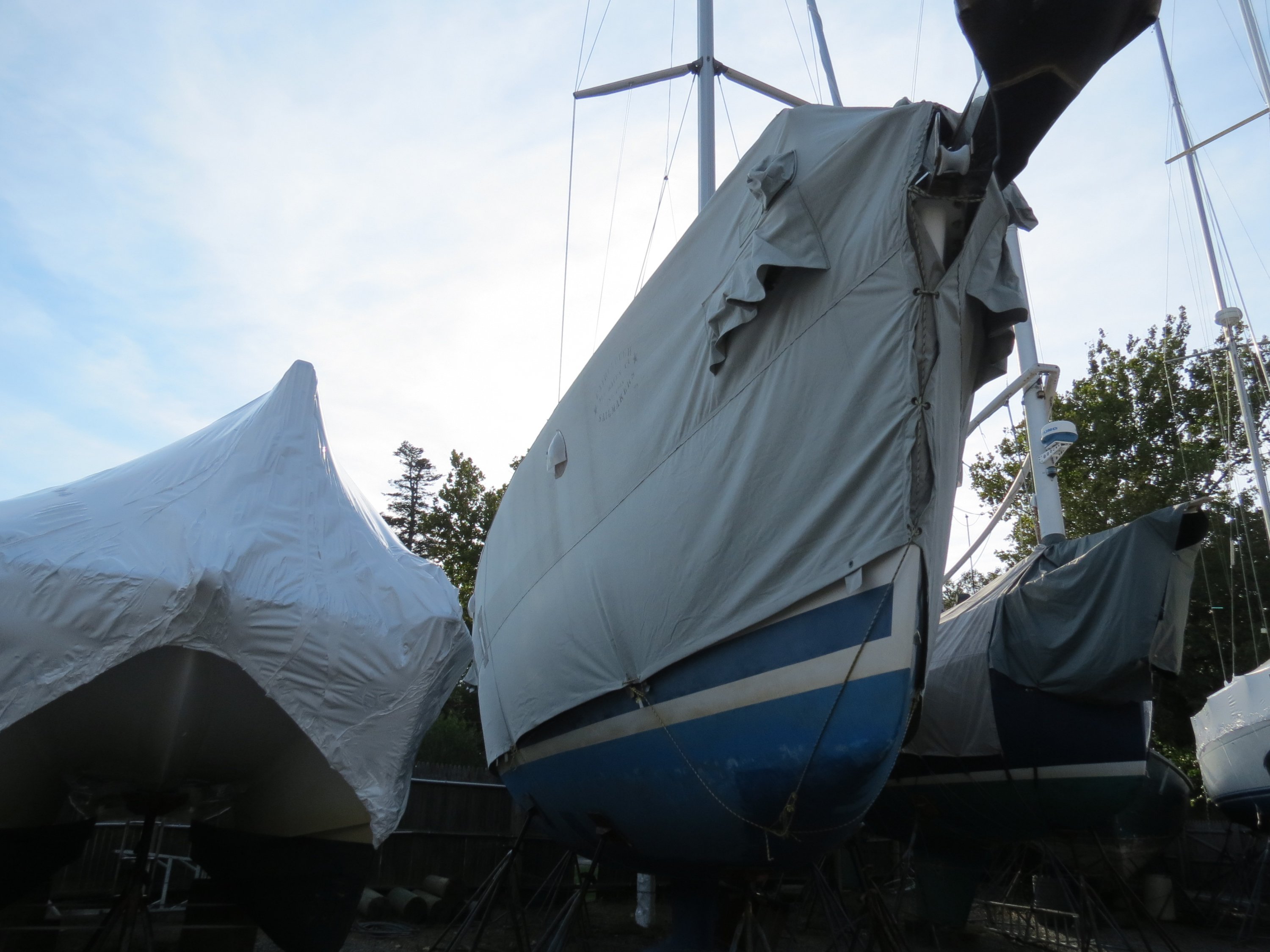

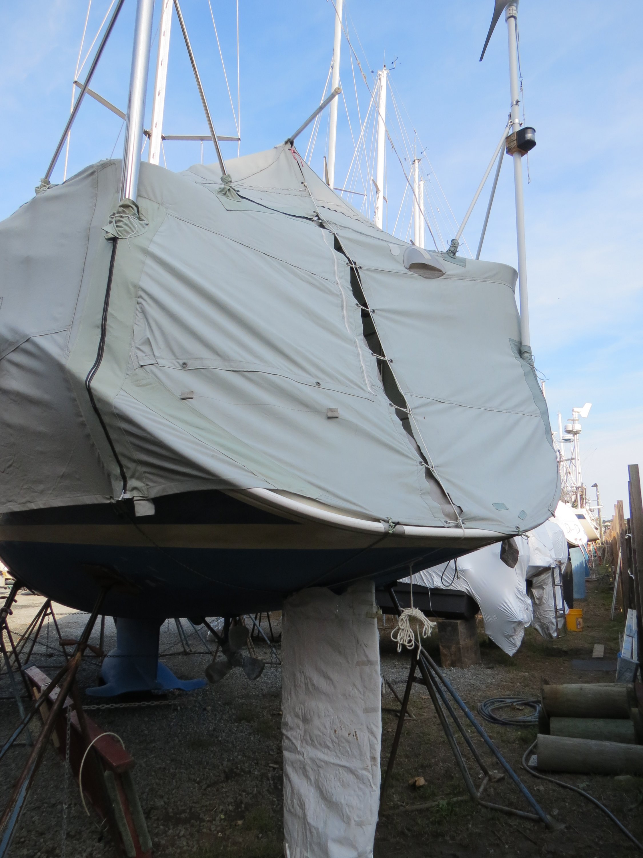

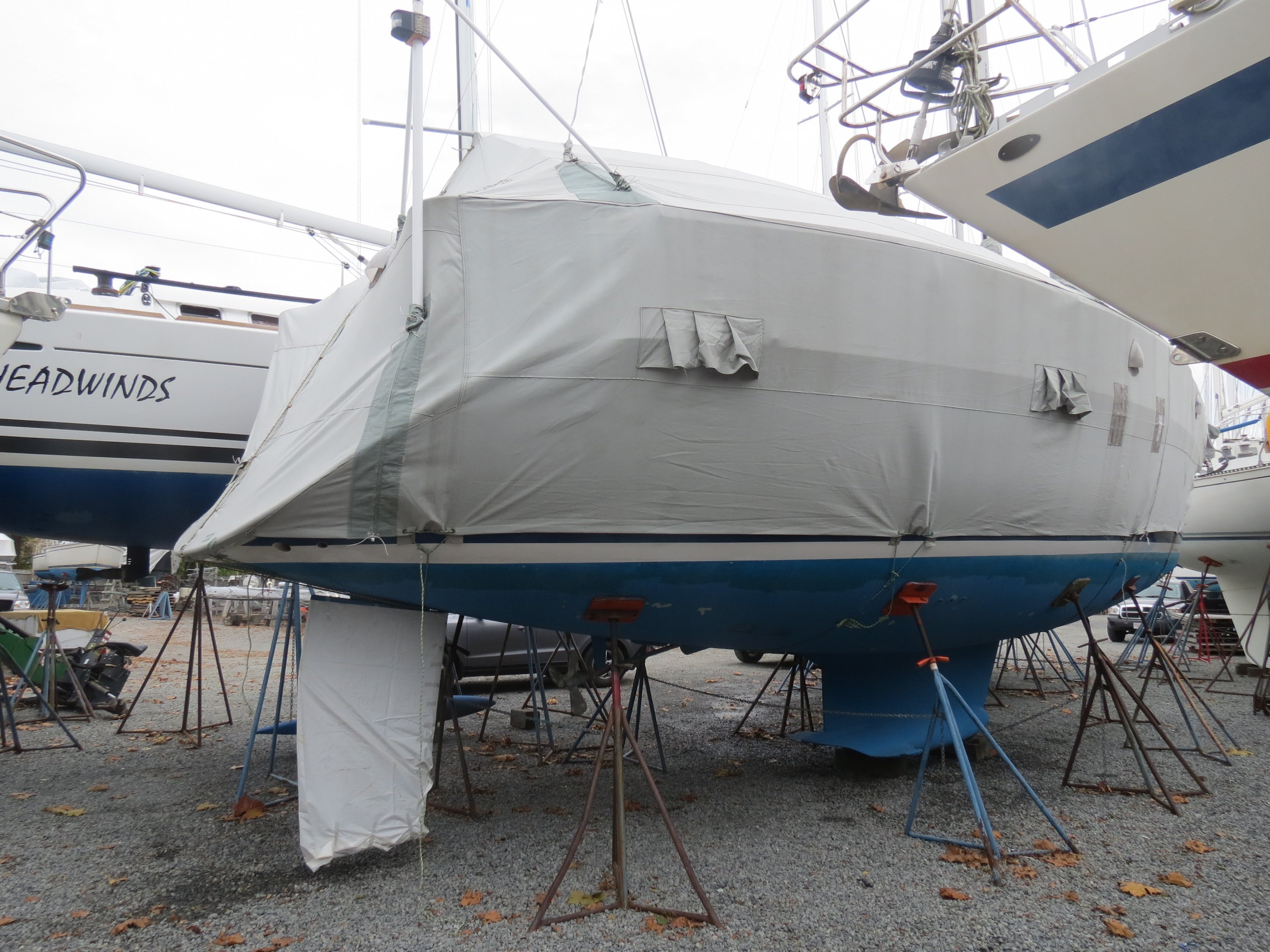

I have a Fairclough Cover made out of Cotton Duck. I have used it for 18 winters. I have modified it over the years to accommodate a wind generator and a radar pole by putting in cuts and zippers. For the last 5 years or so I have suffered thread failures that required me to either apply tape in the fall or hand stitch in place. Fed up with this constant problem, I went back to Fairclough in Essex, CT and had them restitch the cover. They told me re-stitching is needed about every 12 years.
I believe that the cotton duck material allows the cover to breathe and will eliminate a lot of condensation on or in the boat. However, since the weak point of all sewn items is the thread, I would insist that the cover be made with the lifetime Tenara thread. The thread itself is about 3-4 times the price of Dacron thread, but it shouldn't add more than $75 to the cost of the entire cover.

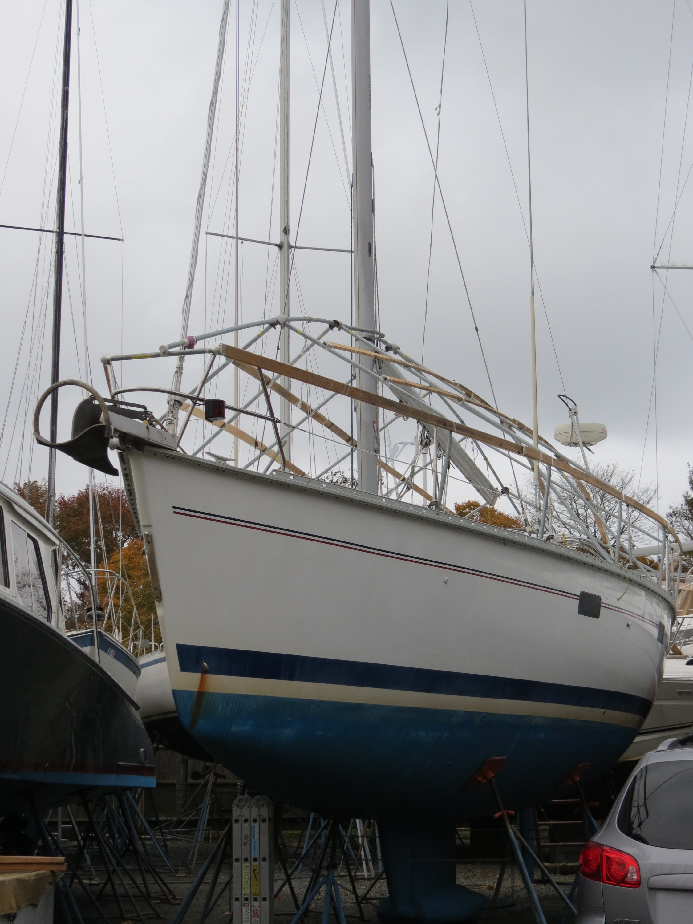

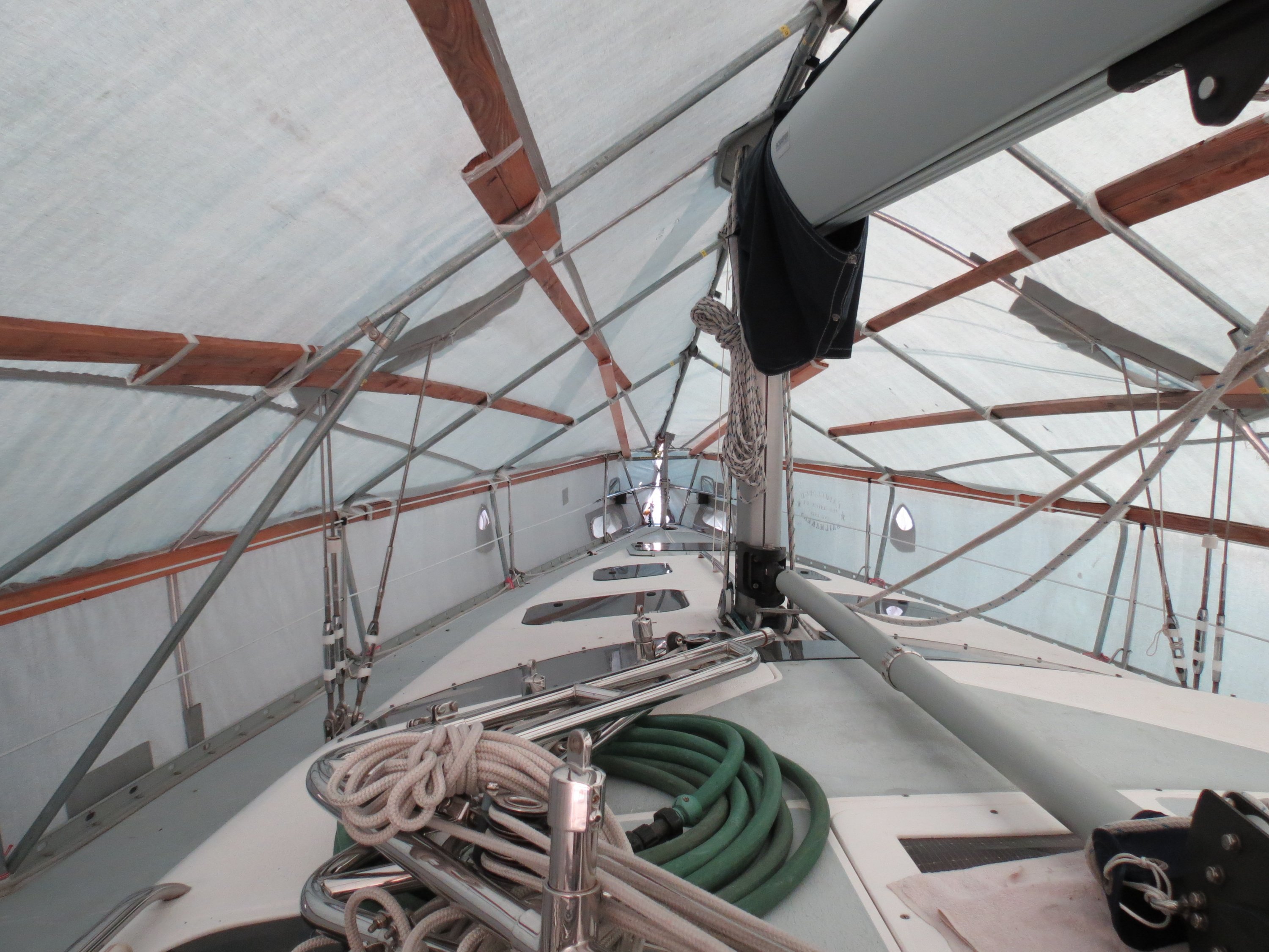

Regarding your question about putting the cover over the lifelines- sharp edges are to be avoided at all costs. My framework has 1x3x12' wood strips taped to the lifelines and across the metal legs that sit on the deck. The wood strips support the cover from sagging with a snow load and at the lifelines they eliminate the sharp edges.
Below you can see pictures of the framework with the wood strips, the inside of the cover after installation, and the outside view.

shemandr is mostly correct with his assessment of the Fairclough cover. I cannot imagine trying to install this cover or a similar by myself. It is definitely a two-person job. It takes my friend and I 8 hours to erect the frame and put on the cover. And we have been doing this for 18 years so we are well beyond the learning curve. For my 40' boat the cover is in two pieces and I wish it was three pieces. The piece from the mast to the stern is very heavy and it takes both of us to horse it up a ladder and on-board. Rolling it out on the framework also takes two people.
I have never had a problem with loosening frame members, but we have added additional wood strips to better support the snow load than were originally designed. I have had some fitting and closing issues at the bow and stern, and I suspect that the cover has shrunk over the years- can't prove it, but that is what I think. I do get some small gaps at the stern or the bow that do let in a little snow and rain, but it is minor. Attached are pictures of my bow and stern from covering this fall. Some years the gap at the bow is worse and the stern is tighter and other years it is the opposite. This year the stern had larger gaps. These gaps could also be caused by the framework not being pulled down as tightly one year vs another.
But for all of these issues, I must admit that this cover is the best I have seen. One of the pluses is that the boat is quite warm in the sun under the cover and you can get on-board during the early winter and late spring to do work. A heavy flannel shirt is about all that is needed to work comfortably.

What is shown in the photos and what your describing is similar to what I have now except I have a one piece heavy duty rip stop tarp which has shown absolutely no wear in the first two season. It takes a full day to assemble the 3/4" thin wall conduit frame and one day to manhandle the tarp into position, tape the joints and rope it down.
I think it is a pretty good system and most parts are adaptable to a different boat size. If I had the time, I would sew my own cotton duck cover, making three pieces that zipper together and install the grommets for the lines. But that is a bit of a project on its own.
