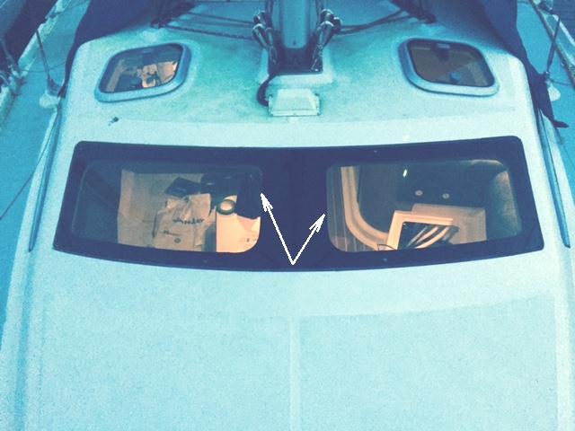

It's not the thickness of the 795 that counts but the width of the deposit of 795. Moisture from the air does not penetrate through the acrylic (on top) or the fiberglass lip (below). The water vapour enters along both edges of the joint and proceeds through the width to the middle to fully cure the sealant.
I have no idea how many years this hatchlight took to cure:
The narrow borders are about 2" wide. This must be like a 2" thick bead of 795 curing. There are about eight black headed screws around the perimeter which were used to hold the whole thing together for many months before it was set. Screws were left in and it's impossible to see them until your nose is on them.
