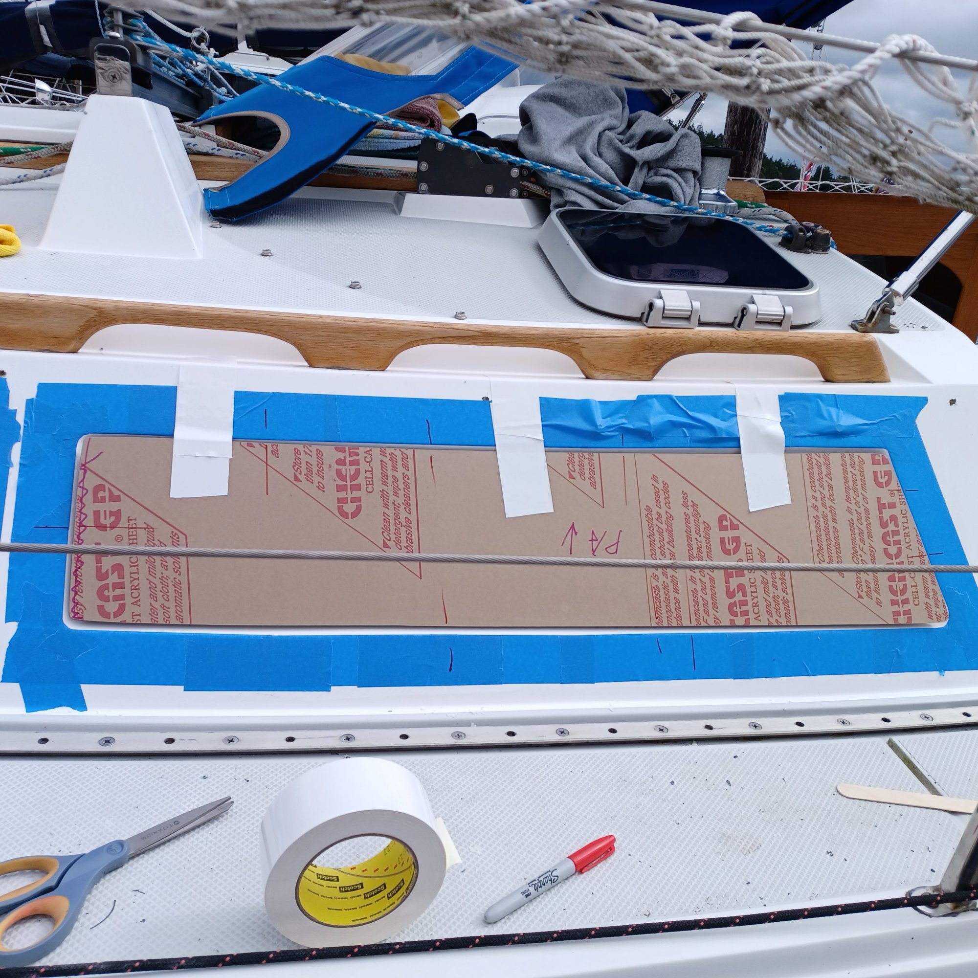

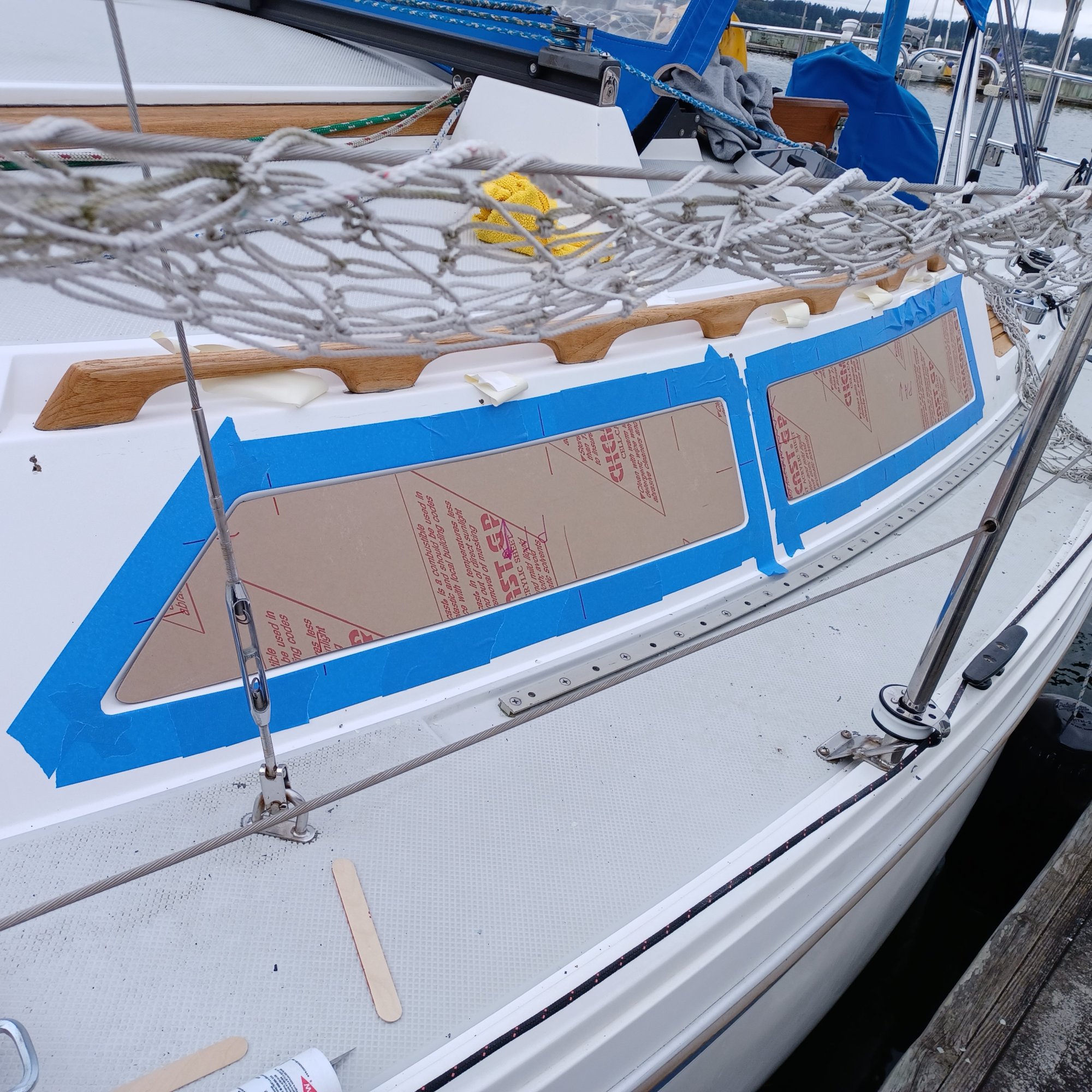

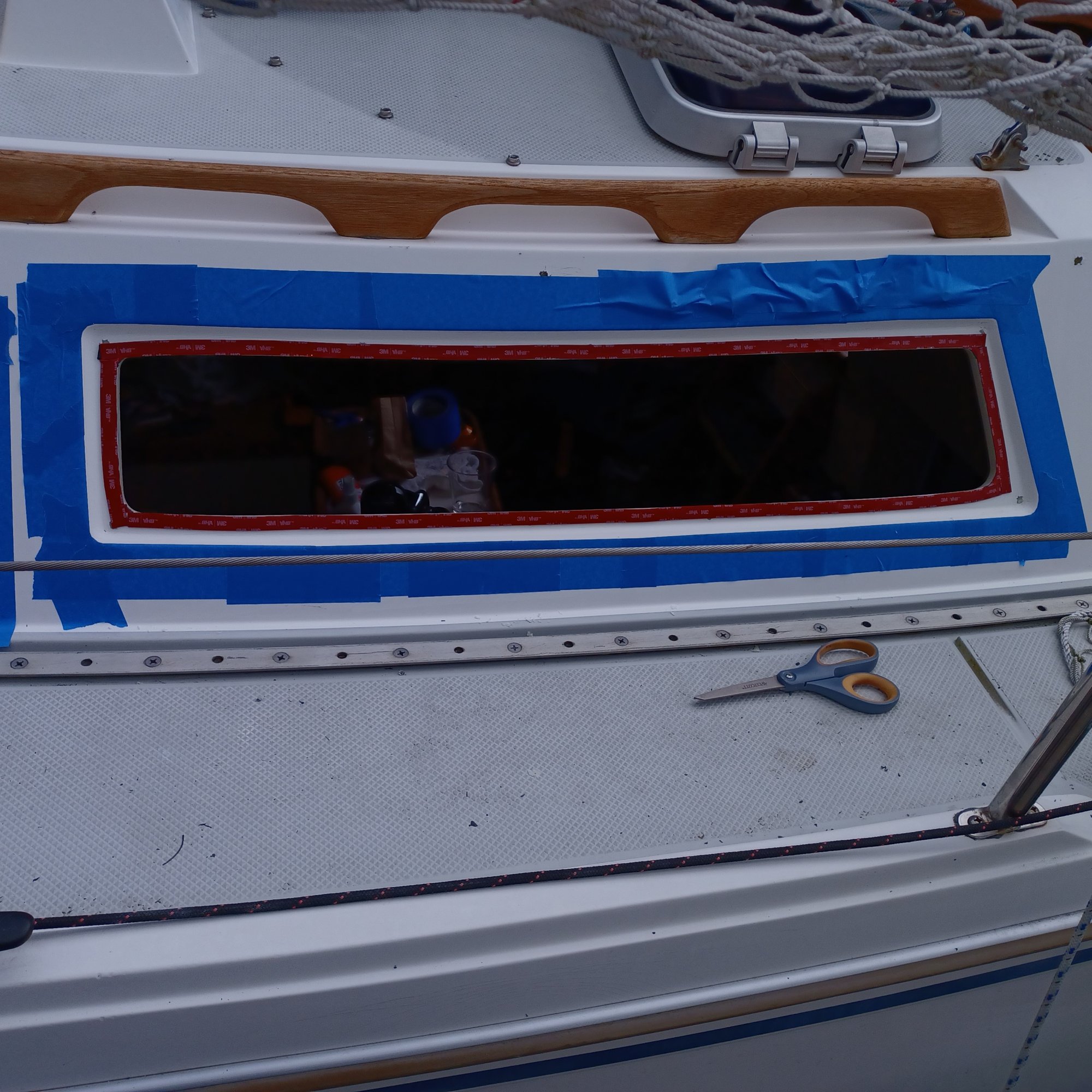

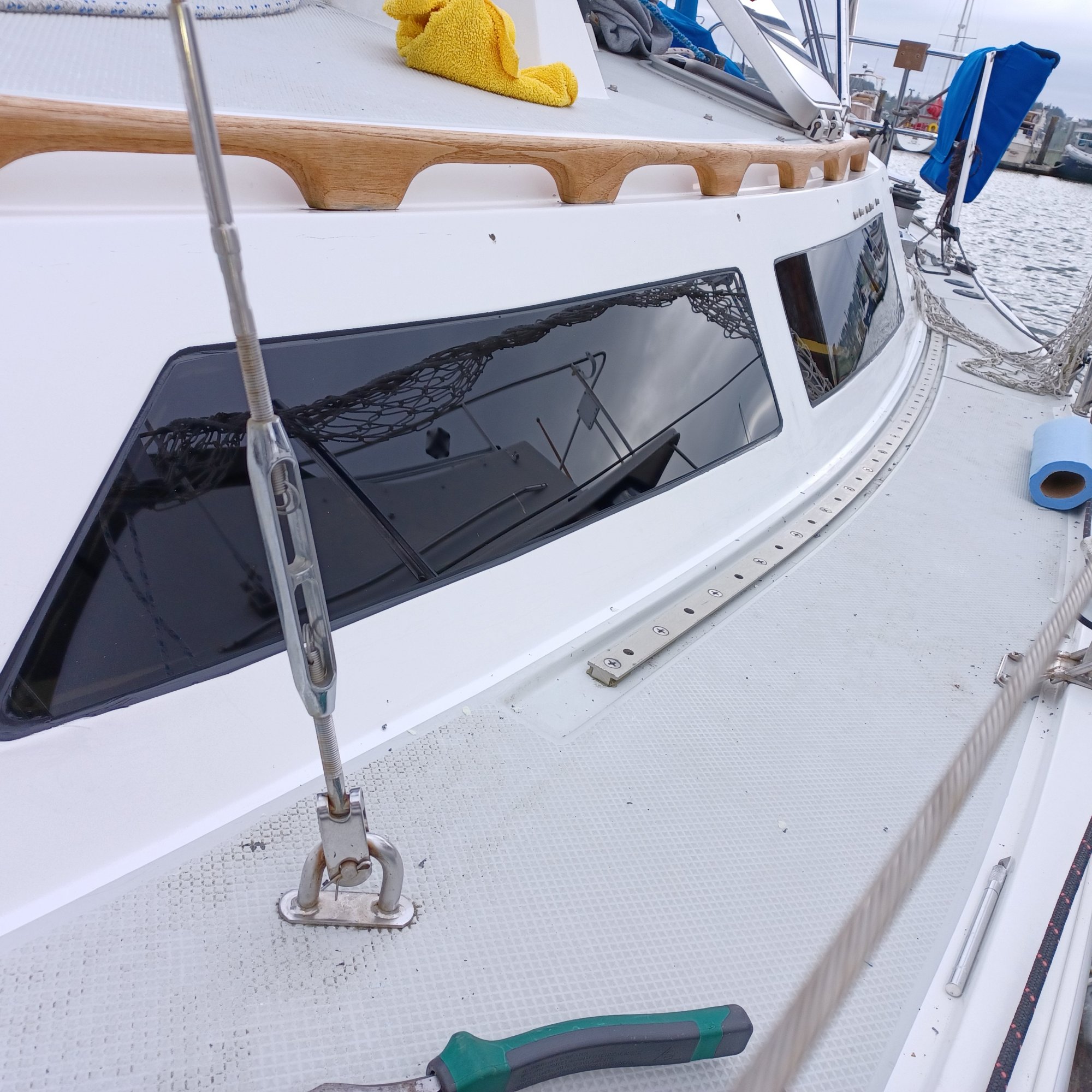

Yesterday I finished installing my fixed portlights in my 88 C30 which a "frameless" system. In the originals, the lens was held in place with screws around the perimeter but I used UHB tape and Dow 795. Here are some photos. The three vertical strips of white tape form a hinge to allow the lens to be properly aligned and then rotated up out of the way to strip the paper off the back and wipe down with alcohol before sticking to the tape.

I used Don Casey's article for the basis of my replacement but used a different slightly thinner VHB tape then the 4991 he called for because it only comes in light gray which causes the problem with shadowing he described. I covered all of the white with the black VHB x 1/2" wide and then infilled the radius corners with little bits to cover the exposed whiteness there. I then pinched the tip of the silicone tube down to a very narrow slit that allowed me to fill from the bottom of the void so that it got all the way down to the tape. A bright light from the outside confirmed not white showing through.
I used the dark smoke cast acrylic.

I also watched Boatworks today video and his anxiety on getting it located correctly when setting it onto the VHB was why I used the tape hinges. It made it so easy to place. Position the lens where you want it before pulling the backing film on the VHB. Mark reference lines horizontal and vertical on all edges. Apply several tape hinges to the top edge (I used 3m Preservation Tape which is great stuff to have on a boat) Hinge the lens up and pull the film and paper. swing it down into place, checking the reference lines before touching down.
The tape was plenty strong enough to put the small bend into the lens to match the cabin curve.
