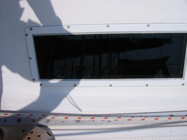

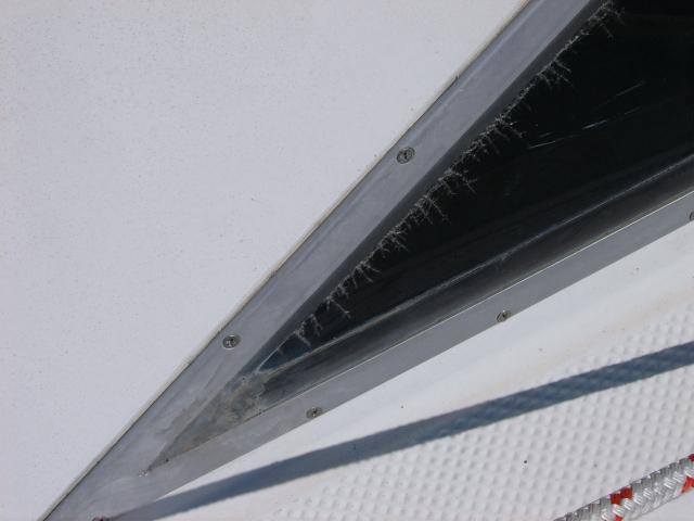

I am in the middle of removing and refurbishing the fixed ports in our '83 H34. They are the aluminuim frame. Basically I took the window out, removed the old Plexiglass, cleaned thoroughly- this is the hard part- and painted the frame (white) and replaced the plexi with 1/2 inch thick. Cant find the old weather stripping- didnt like it anyway so replaced with Dow 795 in grey. Used Butyl tape to hold the plexi to the frame. I plan to post the detail in the knowledge base but here are before and after pics- they are two different windows but you will get the idea. Total job should cost about 150$ .

kloudie- it might be worth trying to pull the plastic frames and repainting them with Fusion plastic paint. The frames on mine came out very easily- I probably could have pulled them out if they were plastic with no breakage, You could then replace the plexi with 1/2 inch and caulk around with white Dow 795. I used grey butyl tape tp secure the plexi to the flange. I have never seen aluminium extrusion like the window is made from- You might find something with a search on aluminum extrusions. Let me know if you have any questions. The windows were far easier to get out than I imagined- took me about 15 min to get the window out
