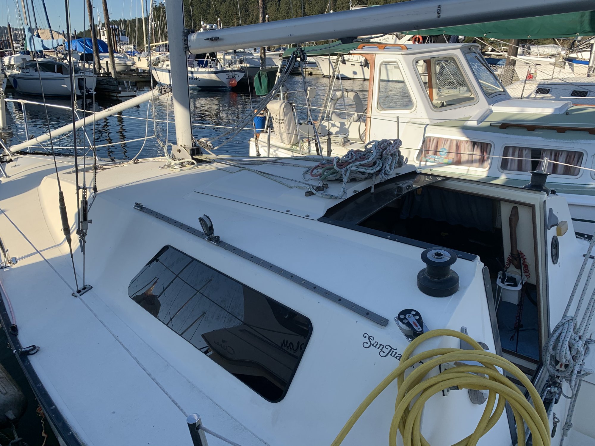

I replaced the windows on my boat with 1/4 inch plexiglass a couple of winters ago and was very pleased with the results. Spent time making a template then used a router to cut the plexiglass and round the outer edge. Painted the strip that covers the FRP black so that there would be no show through. Stuck wooden blocks as guides to the paper on the plexiglass with double sided tape to ensure a smooth one time install. Used the 3M tape and Dow Corning sealant. Biggest challenge was getting the sealant all the way into the narrow gap up to the tape as I did not want a sealant bevel on the outside. Sailed the boat hard and survived a couple of wet PNW winters with no issues
