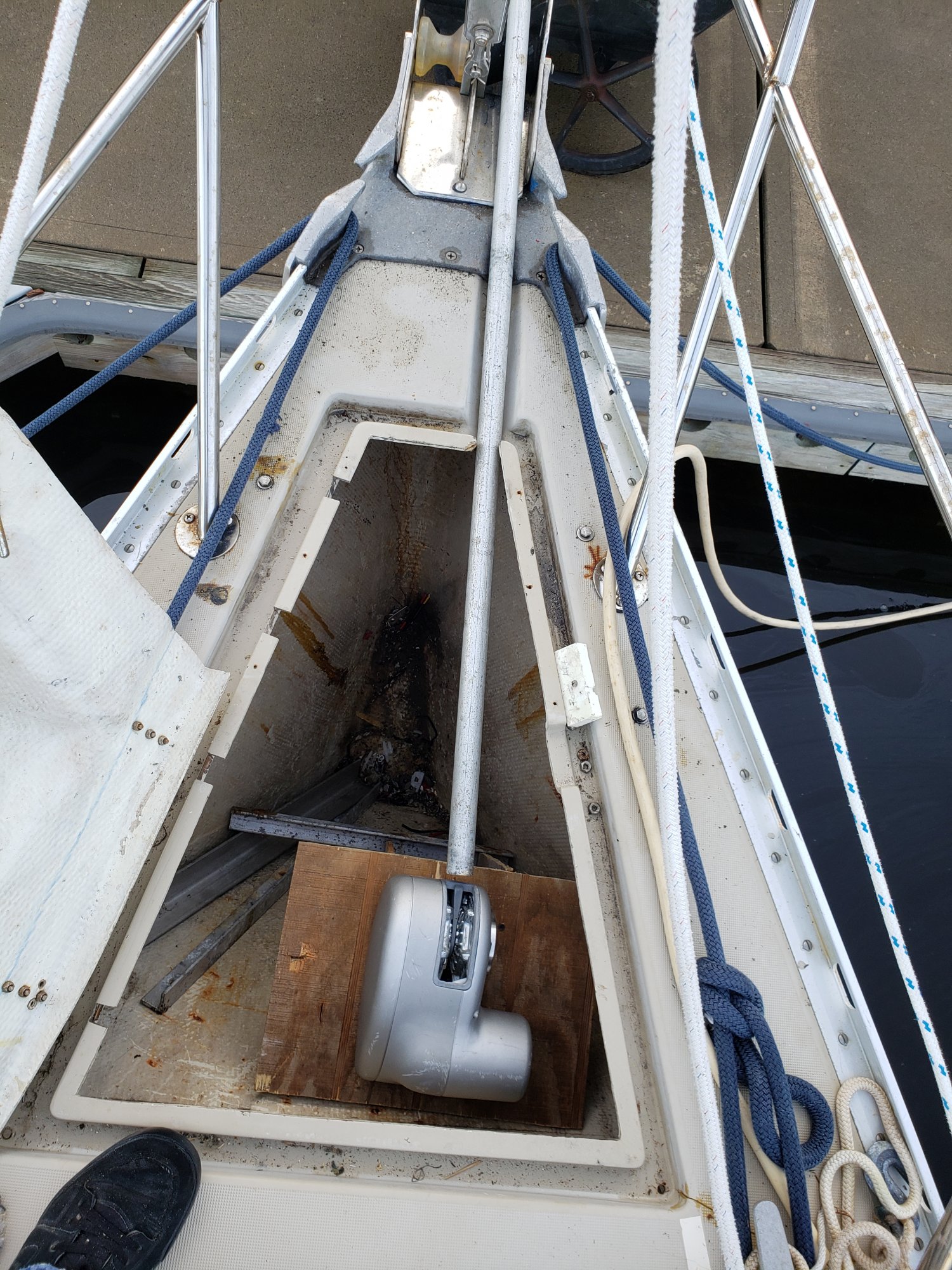

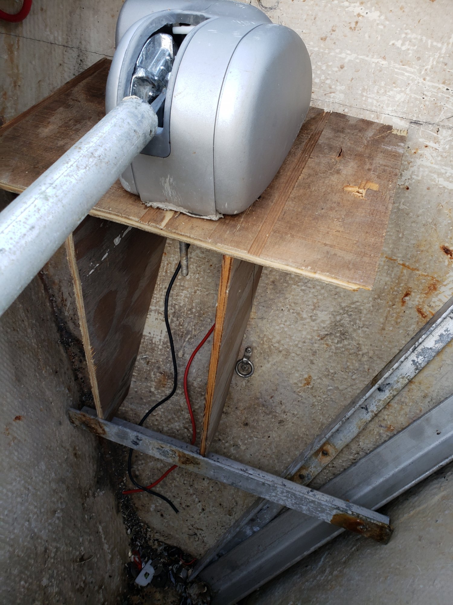

I just did this, on my 1984 oday39. I built a shelf in the anchor locker out of marine plywood them glasses it in, set the shelf angle so that the anchor chain rides perfect thru the hole in the hatch. I considered making just a metal bracket at first, this was more work but helps spread the load. Turned out great. I can send some pics if interested.
May 1, 2019
31
oday 39 39 Jacksonville fl
I just did this, on my 1984 oday39. I built a shelf in the anchor locker out of marine plywood them glasses it in, set the shelf angle so that the anchor chain rides perfect thru the hole in the hatch. I considered making just a metal bracket at first, this was more work but helps spread the load. Turned out great. Here are a couple pic of when I was mocking it up I built that little shelf to help figure it all out. The actual shelf goes all the was across to the hull, I can take some pics and measurements when I go back to the boat this weekend.
