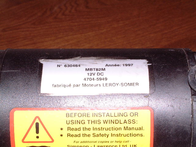

I purchased a replacement 1000W motor for my S-L Anchorman 1000 in my h40.5 in June 2006. The dealer is in the UK, but don't be put off by the location. They do DHL shipping world-wide and I had my motor within a week. The cost was reasonable. I think the motor and shipping was about $400. It was the LEMAC 12V replacement motor (6044580A)- their current catalog shows it as AP700, but I was told it was a 1000W motor not a 700W. The current price is about $335 before shipping. Check the power and please let me know if it is not 1000W.
Their website is:
http://slspares.co.uk/parts.php?product=Anchorman+Power+Windlass
The original motor was made by Leroy Somer and IMHO is a real piece of junk.
The model number of the original motor is shown in the picture below for your reference.
