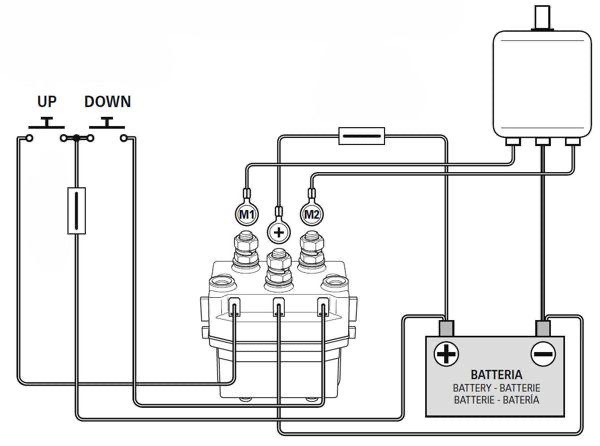

1. You can’t remove the relay, it must be replaced as it’s needed to handle the heavy current that the motor demands, whereas the control switch and wiring are light duty. The way to bypass the Beneteau engine power interlock is to run a battery ground wire connection straight to the relay control connector for it. Also, the engine doesn’t actually need to be running but the engine power needs to be on. See diagram below (from Quick) which shows a typical windlass control configuration.
2. Your comment about the arc causing wear is correct. Usually it causes intermittent operation before totally failing, but after winter storage a hard failure wouldn’t be surprising. It’s a good idea to keep a spare on board.
Ok, I've seen two with a relay in the engine compartment, but yes, essential the ignition needs to be ON for the windlass control switches to receive 12 V. By having it wired this way for charter use, it avoids accidentally depleteeting the house battery. Beneteau does other things that are charter friendly but owner unfriendly like hiding most of the 12V fuses/breakers behind a panel (DIN rail mounted).
With an owner mod consisting of connecting the windlass up/down SWITCH 12V input directly to the house panel (5A breaker) and moving the large gauge motor power cable from the start batt to the house batt, an owner can adjust the rode length anytime, without having to start the engine, even if the start batt is switched off.
This control wire from the engine (alternator?) is wired G1 if I recall correctly, and is usually mod no 1 by most owners. Some dealers would even ask new owners if they wanted this change before delivery....

They do it on boats designed for charter because they have problems with idiots who run the house batteries flat. This requires them to start the engine (it doesn’t actually need to be running, just powered on, but the alarm will annoy them until they start it).
On the Leopard cats it is done by a circuit to the engine power switch relay that interrupts the windlass control relay power (on DC ground) unless engine power is switched on. The simple fix is to run a direct light duty ground wire to connect the push terminal of the control relay to a DC ground (in place of the factory wire). Refer to the diagram I posted earlier in this thread.
