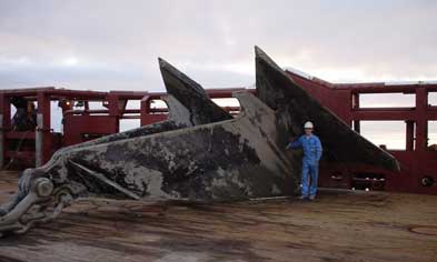

5.5 hp and rated for 9600 lbs?
Now THAT will dim the cabin lights. A windlass can be had for $600-1000.
What are you using for an anchor?
