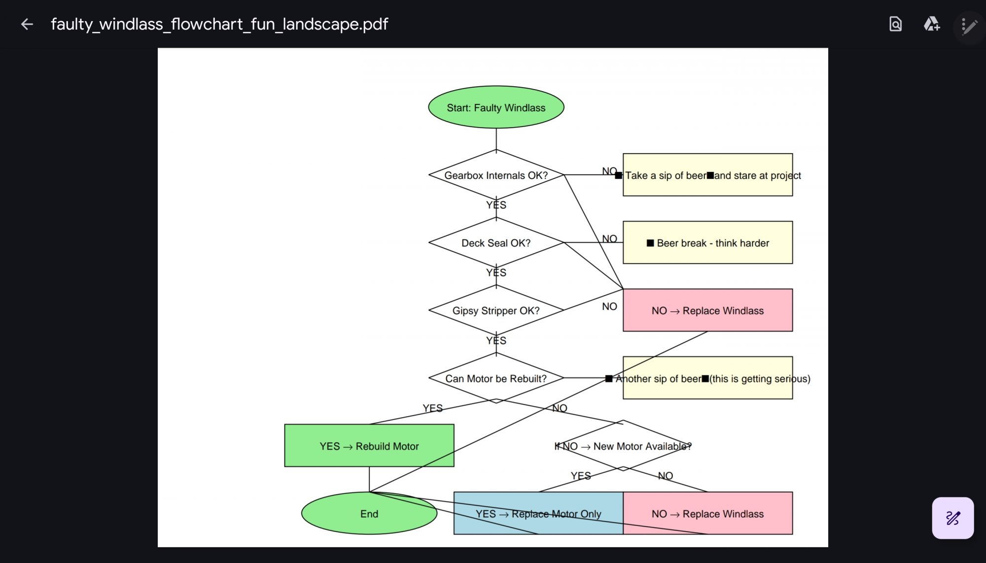

Good idea, but I'd switch the order of questions:
What condition are the gearbox internals?
How's the deck seal?
How's the gipsy stripper?
Not all in excellent shape? Replace. All in excellent shape? Can the current motor be rebuilt? Rebuild motor.
No? Consider finding a new motor. Can't find one? Replace.
Check the Lofrans, similar footprint - may need some modifications. Look at other windlasses to see if any are a better fit.
