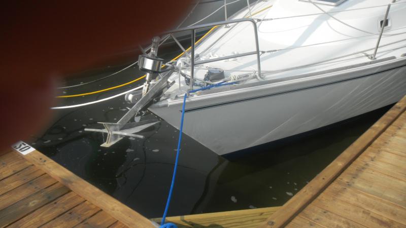

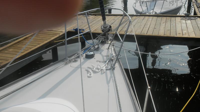

I put a maxwell windlass on my 36-2. I mounted it in the front half of the original anchor locker hatch by putting a pair of aluminum angles underneath that extended across to either side beyond the hatch for strength. I cut the front of the bottom of the old anchor locker out and glassed deeper one in that extended to about the bottom of the inside v berth hatch. Then I cut a drain hole to let out the water through the bow at the bottom of the new locker. I also cut the back of the old anchor locker hatch loose in front of the lock so that I could still use the rear portion of the old anchor locker to hold the washdown hose. It also lets me in to the anchor locker without having to unbolt the front part of the hatch and the aluminum angles. It works fine. But I will tell you that I made a trip down the Chesapeake in heavy seas when it was half finished, the new bottom was not glassed in, and I got a lot of water in the bilges when we took green water over the bow.

Actually I cut the anchor locker hatch side to side not fore and aft. The after part only has one hinge and the lock but it works fine. The forward part can only be opened by removing the four bolts holding it to the aluminum angles. I only planned on the windless using one anchor at a time. I put the 2nd anchor roller set up on because I did not like the original one on the boat and this one projects the anchor out further over the bow. The windlass has to be a little closer than I liked to the bow so that the rode will fall down in the deeper portion of the locker. On the plus side there is room for a small anchor and rode in the shallow after section or dock line storage on the bow etc.
I bought a premade anchor line for the windlass 15' of chain and 150' of line. I could have made the locker deeper and gotten a longer road but this was good enough for my needs. I also carry a second chain and line in the quarter locker which I could add on in an emergency. But we are really shallow in my cruising area. I have a bigger danforth I use when we anchor out to hide from hurricanes, but I have not needed a longer rode. To be honest for Irene, i couldnt find the bigger shackle I need for the larger anchor and I had to use the regular one. I only dragged about fifty feet and Irene's eye went right over the boat.
I might note also that I did beef up the underside of the hatch a little and placed spacers because the aluminum angles are held off by the lip of the anchor locker opening. Also, the after two bolts that hold the windlass down go through the hatch and the aftermost aluminum angle. Essentially I would have to tear the foredeck off to remove the windlass.

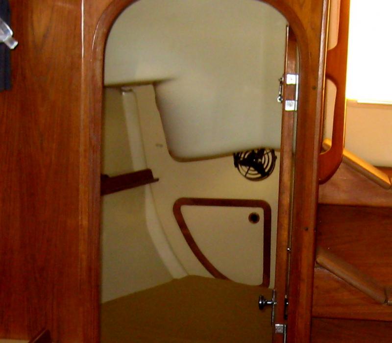

On another subject, I like your idea of a small cockpit locker. I cut an access panel in the aft stateroom, very similar to the one in the vee berth to access the steering gear and other items below the cockpit. Way easier than dropping down into the cockpit locker and crawling around aft of the steering mechanism and then trying to turn 180 degrees to get back out.

I will try to remember to take photos of the aft hatch in the quarter berth area, next time I am at the boat. It came out pretty well, I think.
Jun 7, 2006
13
- - East Blue Hill, Maine
Here's a photo of the aft cabin. You can see the hatch on the aft bulkhead. I was really just shooting the saloon, and forgot to get a closeup of the hatch. Still, you can get a good idea.

Great! that's just what I was thinking of doing on mine, only I was going to cut a square hatch. I think I like yours better.
