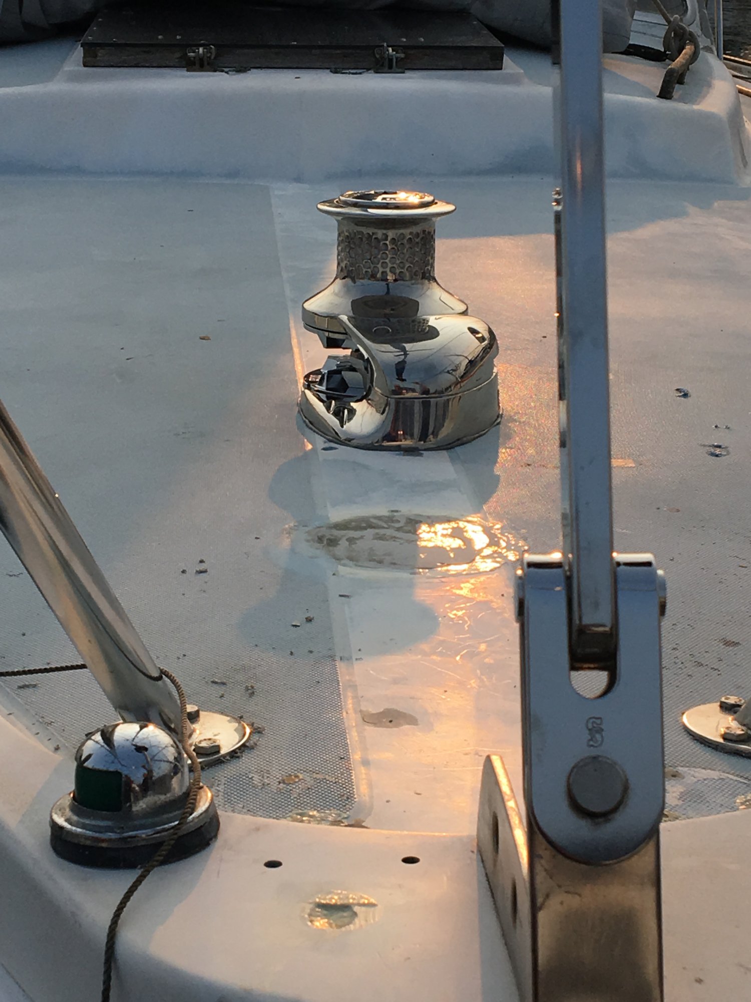

There was never a windlass made for the Hunter, you select one that fits. This is the one I installed back then. I suspect our anchor lockers are the same seeing as they are both 1999 vintage but even allowing for different lengths.
This is the windlass I installed.

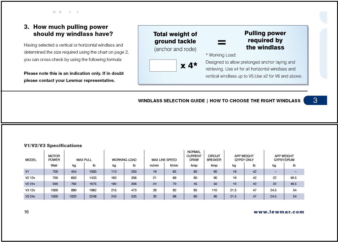

Proper sizing is a major undertaking if using a Lewmar windlass due to their excessive layers of BS.

24,949
Nice writeup. I also bought the Lewmar V3. It has proven to be a fine selection. With no "below a covered hatch" anchor locker (1973 boat with deep inside the boat locker) the install went rather easy. More time was spend running the cables through the boat than the cutting a hole in the deck and fitting the windlass.
