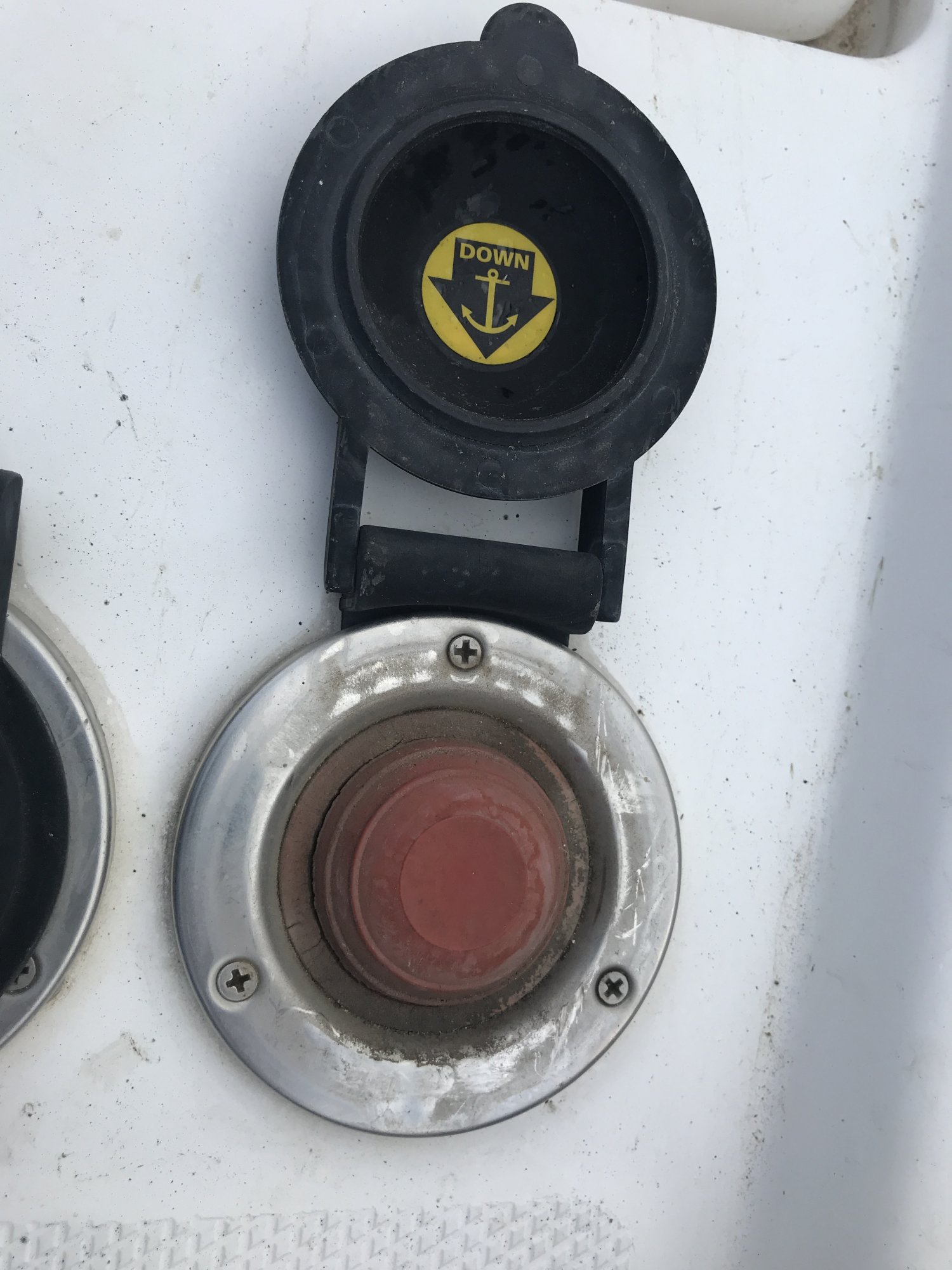

I have a Simpson Lawrence vertical windlass with Lewmar deck mounted foot switches for up and down. The red and black rubber inserts are cracked and it's just a matter of time before water/dirt infiltrate and make them in operable. Anyone know where/how to order replacements for the rubber insert? Or do I have to order an entire new switch? This specific model is phased out, so to replace the whole switch I think I have to order an adapter plate and a new SX model switch. Pain! It would be nice to just replace the rubber insert if possible. Anyone know a source?

When I replaced my Lewmar electric winch switch, which had a uv damaged cover, I had to purchase a new switch. So I am guessing you will need to do the same.
Jan 4, 2006
7,804
I would guess that no mfg. is going to supply only the rubber inserts for a particular switch so it's on to a new one.
I would also suggest a modicum of maintenance and cleaning to avoid such $$$ problems in the future. A vinyl/rubber sealer would also go miles towards preventing degradation of all rubber/vinyl on your boat.

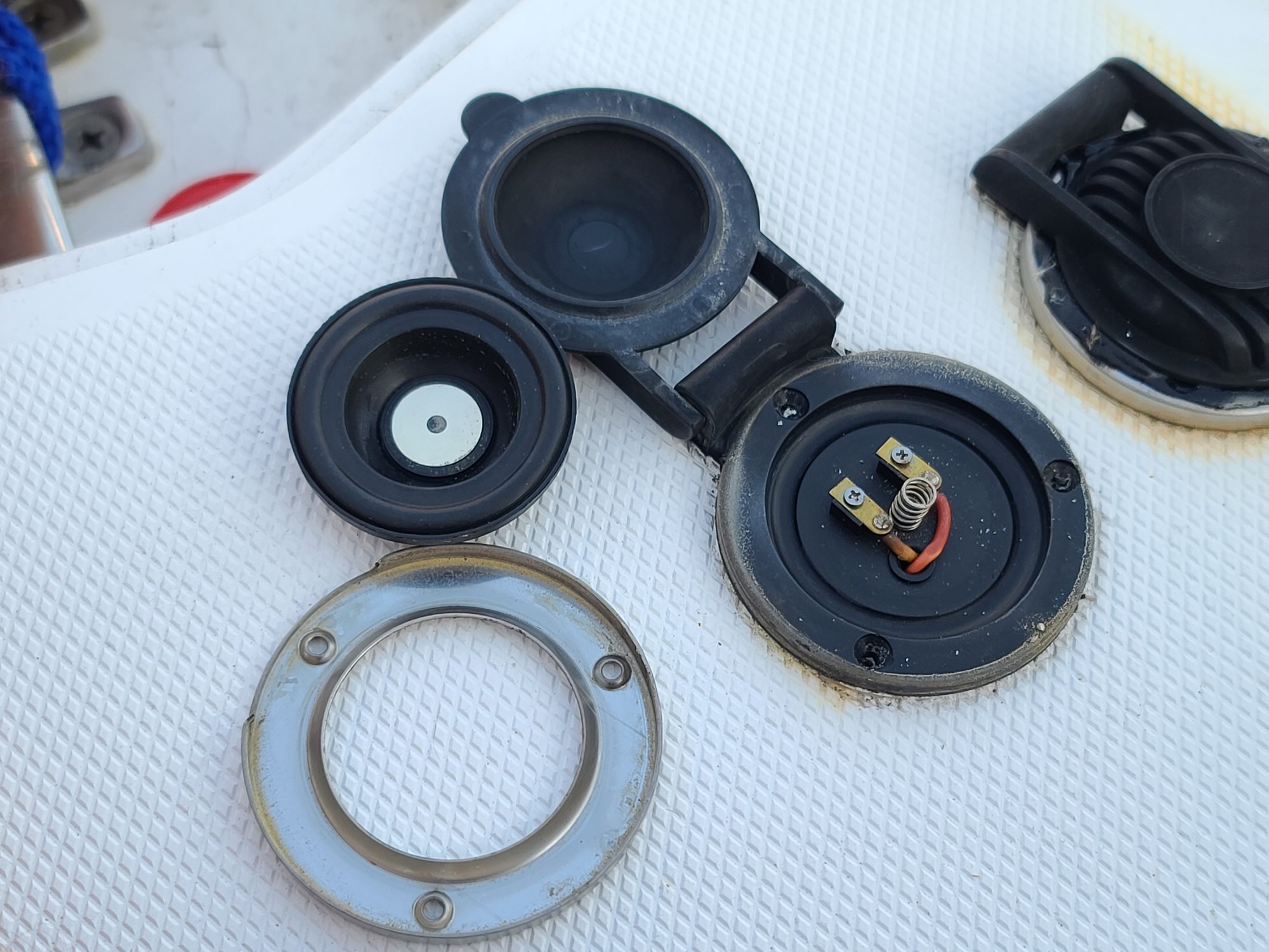

Did you ever come up with a solution? I'm having the same issue with a 45cc I recently bought. I ordered replacement boots from sailboatowners but they weren't the correct ones. They agreed they were wrong and would get back with me if they had access to the correct ones, but that was December 15th. The ones I need have a contact that goes on it's bottom side.

No I haven't unfortunately.....other than buying the replacement switch linked above. I'm mostly a day sailer and anchor infrequently so this has been way down on the maintenance priority list. It's interesting that there is a metal contact in the rubber boot that completes the switch circuit. Not the way I would have designed it. I would have expected a momentary contact, push button style switch with the boot as just a dust cover.
