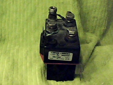

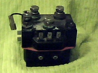

I need help. I have tested the windlass motor directly to a 12v battery and it runs
I've tested the power from the battery to the LEWMAR 0052507 52507 12V SOLENOID DUAL DIRECTION and it's perfect.
here's the problem.
When I step on either the up or down button, the power drops to the negatives and the motor turns oh so slightly. a little bit at a time. I believe it's the solenoid but would like to hear from others who may have had a similar issue. I just want to make sure before I drop $$$
thanks

Sounds like the solenoid to me. Could be the connections, though. How did they look?

...then again, it could be that your batteries are shot; or, there's high resistance in the cables and/or connections from the battery to solenoid.

Thanks for the great replies.
All systems and wires checked so now I must order a new solenoid.
