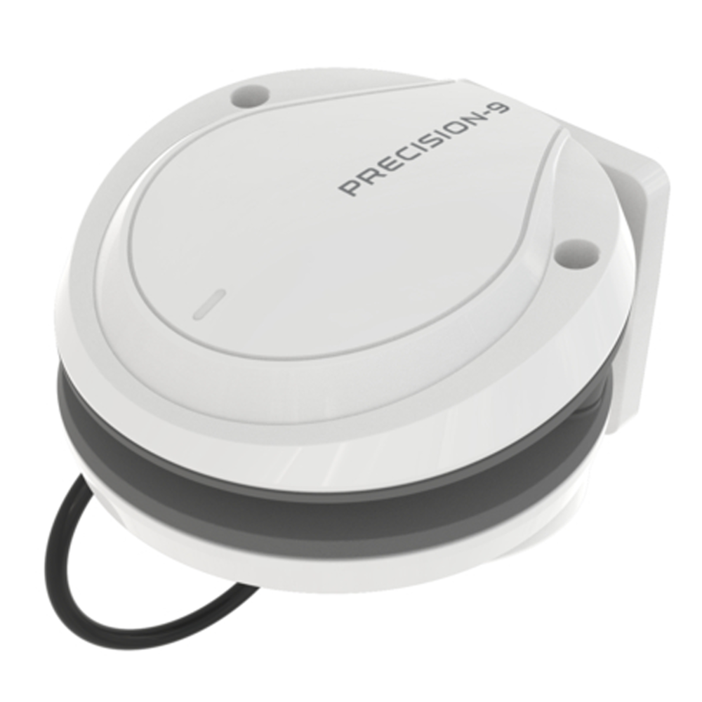

Reading the N2K PG Ns specifications I do not see the a listing for heel or trim as a function of the Vulcan.
Heel would require a sensor.
B&G identifies these as Add On's to your Vulcan.
The B&G ZG100 GPS antenna ( B&G ZG100 GPS & Compass | B&G Sailing USA ) provides precise and dependable position data making it the perfect partner for B&G chartplotters and instrument systems.
The integrated compass delivers accurate heading information for instruments, chart stabilisation for Head Up mode and Radar overlays. It also provides Heel and Trim data for sailing.
  • I am guessing here that the trim data comes from an internal sensor and is communicated to your Vulcan through the NMEA 2000 data transfer. It looks like the "Attitude" data string would be providing the TRIM data

Let's back up a step. If an AP is on the wish list the choices are pretty limited for wheel pilots, either Raymarine or CPT. A below decks AP is also a possibility, however, the cost of installing a below decks AP is pretty high, haven't priced on in a few years, but expect around $3000.
Look at the data requirements for those 2 APs. They may not need the additional data provided by a heading sensor like the Precision 9 or the B&G GPS.
Also consider whether you plan to add radar. In order to overlay radar on charts and to have accurate tracking of radar targets, you will need highly accurate position data such as provided by the Precision 9 and may not be provided by the GPS unit.
If you haven't done so already, map out your electronics needs and want. Develop an implementation schedule, i.e., what's most important and when you will need it. This will help have all the pieces fall into place and make decisions easier.

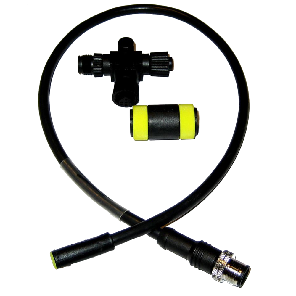

Quick and dirty lesson on Networking. There are 3 standards, NMEA 0183, NMEA 2000, and a NMEA Ethernet (not sure what they are calling it). 0183 is really ancient technology from the 1980s, way out of favor. The various manufacturers had their own names for it and proprietary plugs. NMEA 2000 is young, only 20+ years old there is greater compatibility between devices, still some manufacturers had proprietary plugs. And the new Ethernet standard.
Old NMEA 0183 devices can be connected to N2K (shorthand for NMEA 2000) devices with an adapter. Simrad sells such an adapter (see link). When you install your devices you will set up an N2K network, really pretty simple mostly plug and play. Connected to the network will be your speed/depth/temp transducer and the wind sensor. The network will then connect to a display device and can connect to a chartplotter. Turn everything on and they will all talk to each other and the data will be displayed on the Chartplotter and instrument display. You're in business. You can of course make this more complicated by adding more devices, on my network there are 3 tank sensors, AIS, precision compass, rudder angle, barometer, data recorder, wind, and s/d/t sensor. At this point you don't need all of this, except perhaps for AIS.
The Simrad TillerPilot will connect to the N2K network through the adapter. The adapter plugs into the network at a T and takes the data from the network to steer the boat. For the most part the internal compass on the tiller pilot will suffice when motoring along. When sailing, it is much more efficient to use the steer to wind mode, it is also more comfortable sailing as the AP is not fighting with the wind which will happen when it is gusty or shifty.
At this point, I don't think there is any need for a separate GPS antenna if you have a CP. Get the package with the display for the same money, the display will be more valuable than the GPS antenna. If you need it in the future, add the GPS.

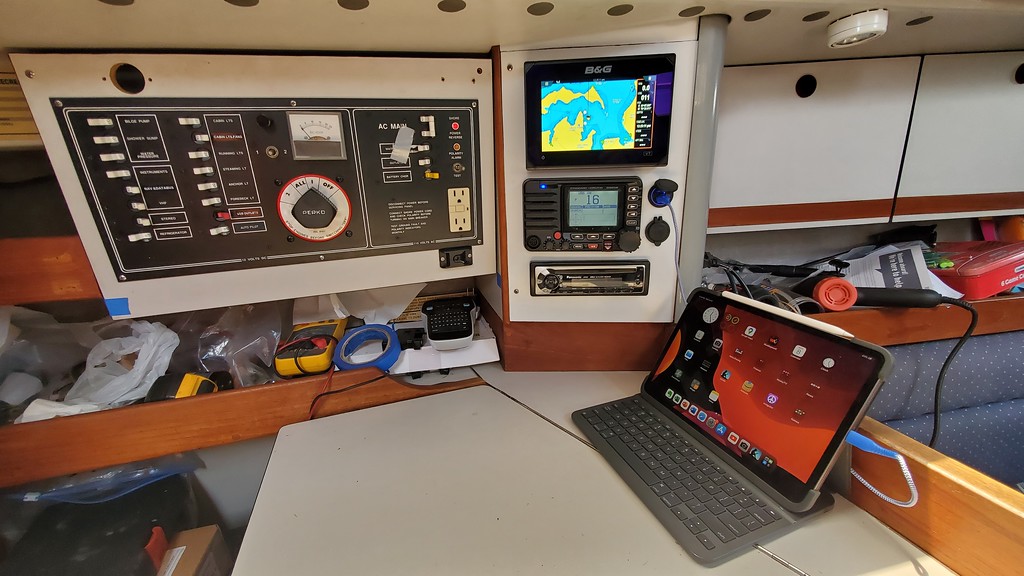

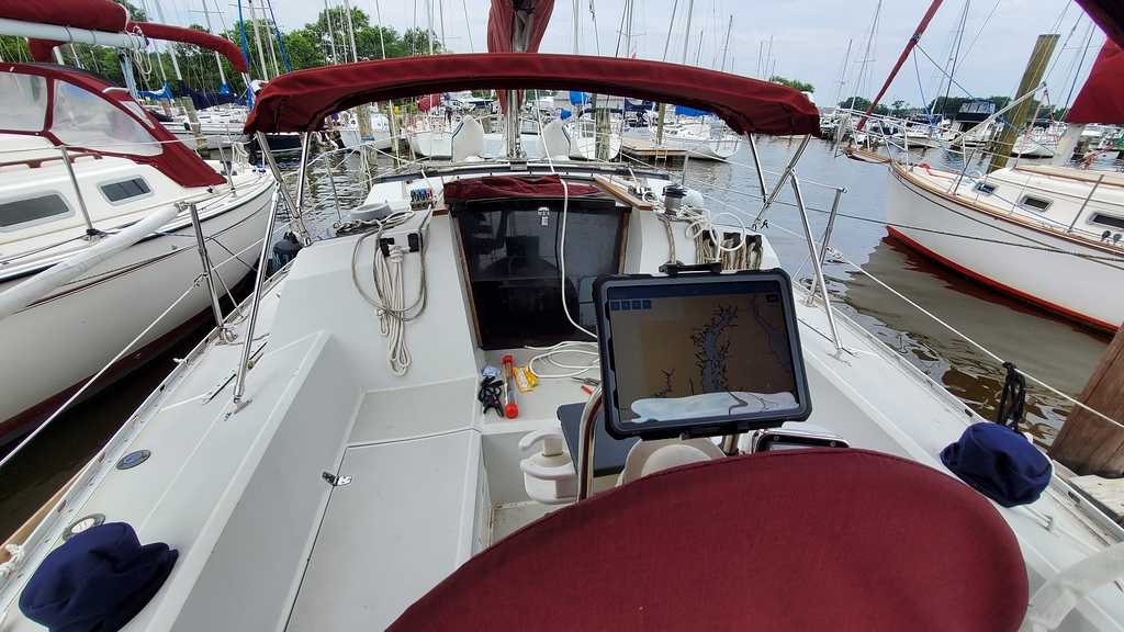

My Vulcan is at the nav station where it stays safe and dry. All functions easily mirror to an iPad at the helm. Mine is always in shade from a bimini and usually in a waterproof case. Simply takes a USB outlet at the helm.
Beautiful setup!
