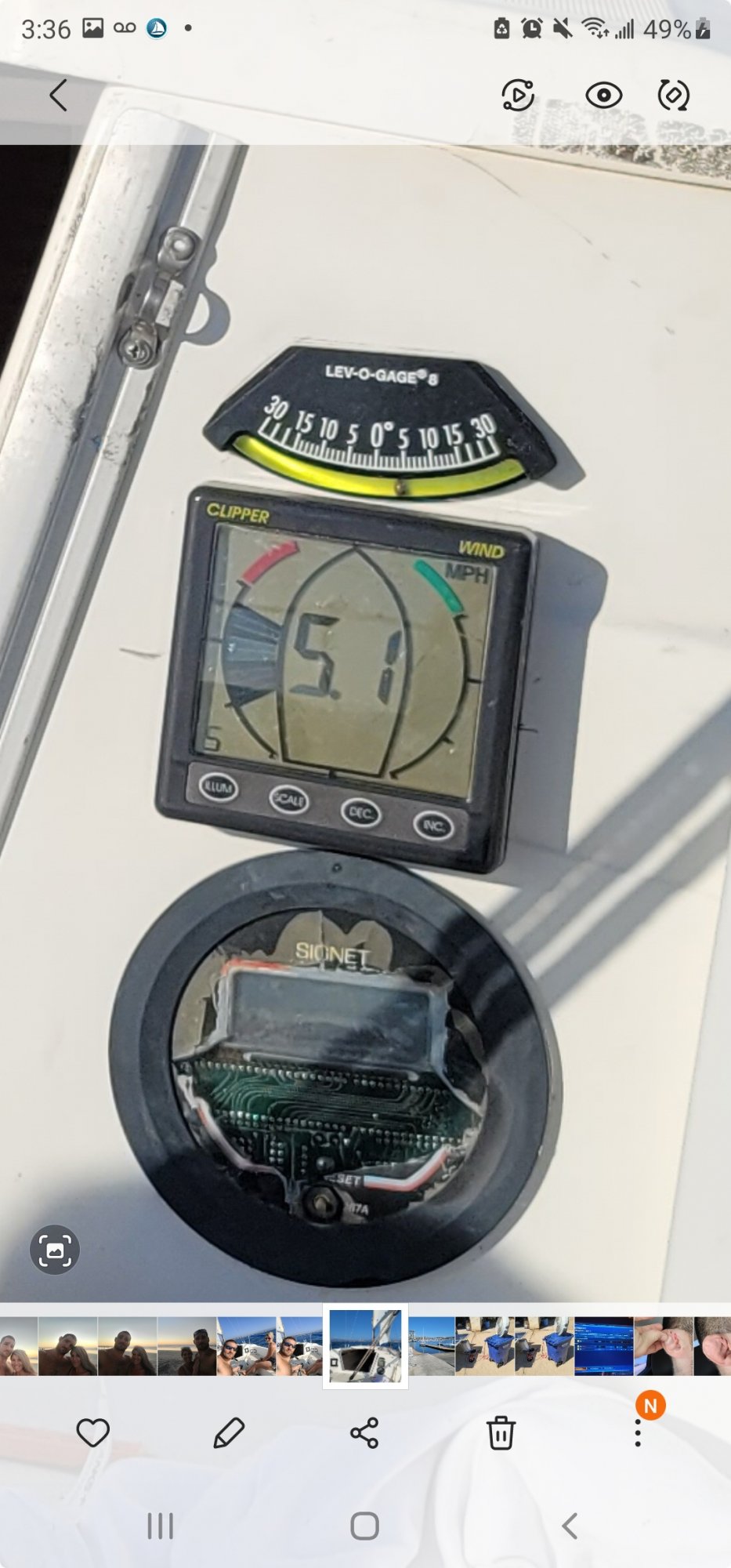

5th time sailing. Still can't sail but this made it way easier...
May want to consider relocating your “heal gauge” to the centerline of the boat for acurate readings. I had my Signet depth sounder refurbished with a new gauge face and push button and calibration at Signet in CA. Cost about $300. Cheaper than a new one and you don’t have to figure out how to fill a 4” hole in your bulkhead because the old style Signets are larger that new versions.

As a fellow 26S owner, let me start by saying "congratulations". It is the best boat for me, and I have fun doing mods.
I use a Windex, and taking it on and off when stepping the mast is done quickly and easily, though on a few occasions I have forgotten. In such cases yarn, cassette tape, or the like tied to the stays is helpful.
As for an electronic wind vane, I would think you would want to remove that for trailering as well. A simple Windex would be more dependable, I think, and not come with the hassle and uncertainty of electrical connections.
