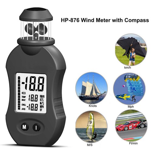

I hang this from my split backstay.
Unlike other portable units, this one does not have to be pointed into the wind, so you don't have to hold it in your hands. Is it necessary? No. But it is not very expensive and it does give you bragging rights when it's blowing like stink!
