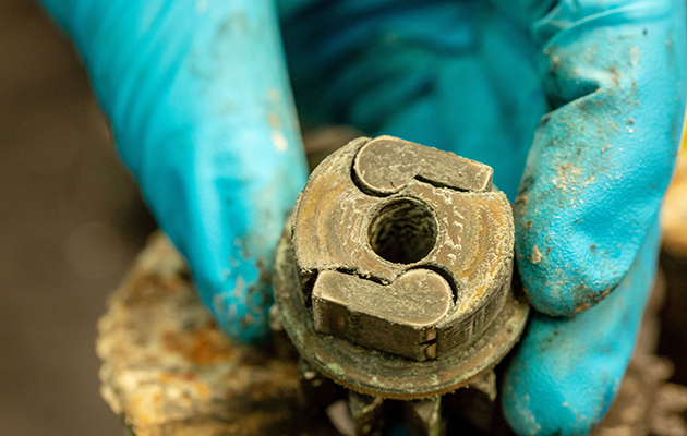

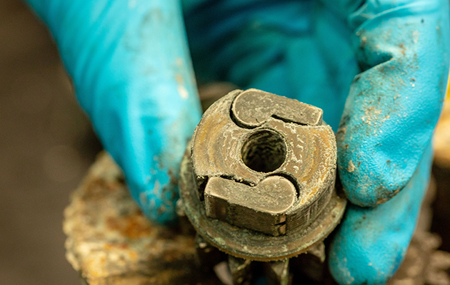

a. There is simply no way you can look at a spring and tell if it is ready to fail. I have hada few fail.
b. There is no way you can evaluate a pawl without a micrometer. Small amounts of wear reduce contact with the seat, accelerating wear of the seat. I have miced pawls after a few years, and they are typically 3-5 thousandths under. That does not sound like much, but a combined pawl and seat wear of 20 thousandths is enough for the pawl to lift and jam, sometimes totally the winch in the process. The third image is probably a total loss due to the cost of parts ruined. Just sayin'.
There are sound, non-profit-based reasons winch manufacturers recommend replacing these parts every few cleanings. I didn't used to replace springs and pawls. After a few spring failures and measuring wear, now I do.

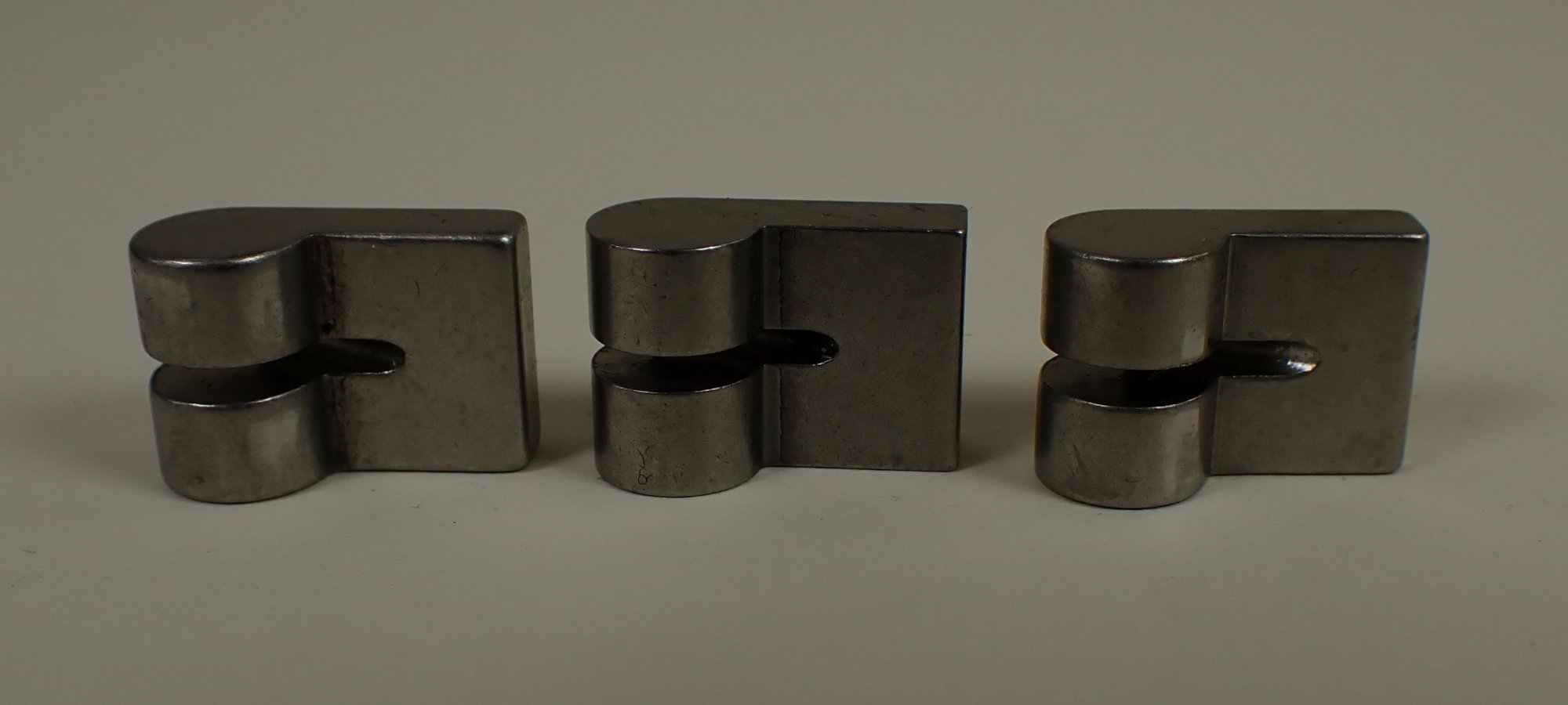

Please show me how you are measuring the pawl, and how are you getting the number to know when you have too much wear.3 to 5 thousandths below what dimensional direction? And how do you set your baseline?
dj
I measured new and old parts with a mic. Several different positions on the diameter of the round bearing end. I also measured the clearances on several new and used winches. One is new and the others are worn 4-6 thousandths under size. Not easy to see. Kits cost $ and winches cost $$$$$$$$$.
Also note that Lewmar and Harken pawls are very close in size but are not interchangeable.
