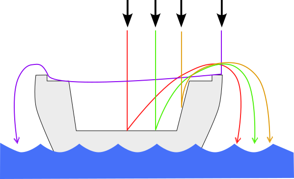

Because anything that is likely to pop out of a winch is going to fly further horizontally than the edge of the bloody box! If you are concerned about that, hang a towel off your lifelines and around the base of the winch.
I don't follow your reasoning. A part would pass through the sides of a box, but would be caught by a towel?
But, that said, I just tape a sheet of plastic or something to drape between the coaming and lifeline. But, a box would work well.
The issue is less about something flying through the air into the water and more about something falling and bouncing or rolling into the water. Often what happens is, when you lift the drum off, something sticks to it as you lift, but then falls out. On my boat, the coamings and deck are carefully designed and calibrated to redirect any dropped object directly into the water, regardless of where the object was dropped. My marina has to dredge my slip every couple of years to remove all of my dropped eyeglasses and tools so I can still get in and out of my slip.
This diagram represents how various objects dropped in my cockpit react to surfaces:
